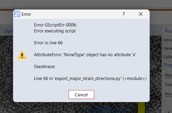

[An...] Posted March 1, 2023 Share Posted March 1, 2023 Hi, I have analogous python scripts to export minor/major strain direction data from GOM Correlate. The scripts work perfectly on a project with only one surface component, and where all strain data is computed at all stages of deformation. My projects have several surface components, and at some stages, the strain data does not compute at all points. The scripts do not specify which surface component I wish to export. Also, the scripts are not written to handle surface components where strain data goes missing at certain points at certain stages. I have attached the error message. I would very much appreciate if someone could advise/help to modify these scripts. Thank you, Anna export_minor_strain_directions.py export_major_strain_directions.py Link to comment Share on other sites More sharing options...
[Th...] Posted September 21, 2023 Share Posted September 21, 2023 Hi Anna, just scrolling through the forum, but hope it isn't too late. Anyways several thoughts here: you can iterate over all components or just combine them to one surface component region and just use this one element for export you can also use the "data arrays" (numpy arrays) to access all values of all stages and don't have to iterate and show all active ones (huge performance increase!) in the data arrays uncomputed values already have a "none" value but you should also use a proper "Try - except" to write correct export strings (but should work out of the box if I remember correctly) Hope this helps. Best regards, Thorsten Link to comment Share on other sites More sharing options...
