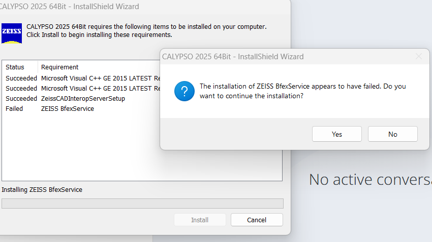

Popular Post [Za...] Posted June 24 Popular Post Share Posted June 24 Hello All, I want to mention on here for those of you downloading and installing the 8.0.1205 Patch, that a handful of CALYPSO users have noticed that during installation, the BfexService failed to install. Screenshot below of an example. The cause appears to be that Bfex is already installed, and simply fails to install a 2nd time. BfexService is only important if you have a LineScan. For users who do not have a LineScan, you can simply click Yes, and carry on with the installation without worry. If you do have a LineScan, I recommend to start the Bfex installation ahead of the CALYPSO installation by hand with admin rights out of the ISSetupprerequisities folder within the CALYPSO Installation files. 8 1 Link to comment https://qualityforum.zeiss.com/topic/26881-calypso-801205-patch-installation-bfexservice-appears-to-have-failed/ Share on other sites More sharing options...
