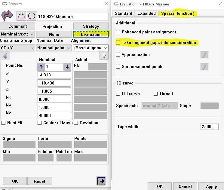

[Ja...] Posted June 25 Share Posted June 25 I’m recalling the raw data points from 3 smaller separate curves into 1 big curve and I’m puzzled as to the results and graphic printout on the report. If I analyze and plot the 3 separately, there’s no problem at all. Now if you look at the supplied plot (the gaps in the plot are supposed to be there), there’s a blue line that’s being added. I don’t know what it represents, and as you’ll see it’s being included in the analysis which makes the results useless. What’s even more odd, is that I can re-run it using the same raw data, and get a significantly different blue line and significantly different answers. Anybody know what’s going on and how do I fix this? Link to comment https://qualityforum.zeiss.com/topic/26893-odd-profile/ Share on other sites More sharing options...
[Ma...] Posted June 25 Share Posted June 25 Not 100% sure but maybe this option would help. Link to comment https://qualityforum.zeiss.com/topic/26893-odd-profile/#findComment-152191 Share on other sites More sharing options...
[Th...] Posted June 25 Share Posted June 25 (edited) Piweb plots behave like this when you have interrupted profile segments. I don't do curve recalls like this, but I assume it is behaving the same. Are you able to use the segment tolerances option in the feature? Honestly, the plots for the new GDT line profile characteristics do not seem well-behaved. Edited June 25 Link to comment https://qualityforum.zeiss.com/topic/26893-odd-profile/#findComment-152193 Share on other sites More sharing options...
[Ja...] Posted June 26 Author Share Posted June 26 (edited) Marc - Good idea but didn't help. Thomas - Agree. Edited June 26 Link to comment https://qualityforum.zeiss.com/topic/26893-odd-profile/#findComment-152221 Share on other sites More sharing options...
