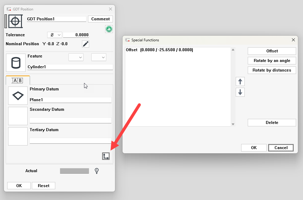

[Ja...] Posted July 6 Share Posted July 6 I’m not understanding how the new GD&T engine functions when doing a best fit. It’s putting the center of the bolt circle out in left field somewhere so when you look at the nominals they’re not even in the ballpark. I can go into the special functions and offset each feature back to where it’s supposed to be according to the print, but then the actuals really aren’t going to be respective of the best fit. What am I doing wrong? Link to comment https://qualityforum.zeiss.com/topic/26937-best-fit-using-the-new-gdt-engine/ Share on other sites More sharing options...

[Iv...] Posted July 7 Share Posted July 7 Could you not add a special alignment offset/rotation? See my screenshot below. This offset allowed me to reposition the nominals to be 0,0. Link to comment https://qualityforum.zeiss.com/topic/26937-best-fit-using-the-new-gdt-engine/#findComment-152549 Share on other sites More sharing options...

[Iv...] Posted July 8 Share Posted July 8 The new engine still allows for the best fit; it just does not show that transaltion/rotation offset amount that was previously shown using the older GD&T. I do wish that this information was there, but I will take the simultaneous requirement addition. If you check the light bulb in the positional callout, it should show that rotation and 2x translation are allowed. That best-fit is still occurring as you explained, to minimize the hole deviation. That's why I recommended using that offset feature; it would provide more useful numbers to your manufacturing team. Link to comment https://qualityforum.zeiss.com/topic/26937-best-fit-using-the-new-gdt-engine/#findComment-152611 Share on other sites More sharing options...
[Ja...] Posted July 9 Author Share Posted July 9 Please sign in to view this quote. Yes it does. But as Richard pointed out, in this case it's using the origin for its' calculations from the center of the plane, not the best-fit center of the bolt circle. If you simply offset the starting pointing point, you're still using a pre-defined starting point rather than the best-fit center of the bolt circle. Consequently, the offset method will tell you if the bolt holes are good themselves, but the nominals/actuals won't be an accurate representation of the best-fit. Link to comment https://qualityforum.zeiss.com/topic/26937-best-fit-using-the-new-gdt-engine/#findComment-152661 Share on other sites More sharing options...
