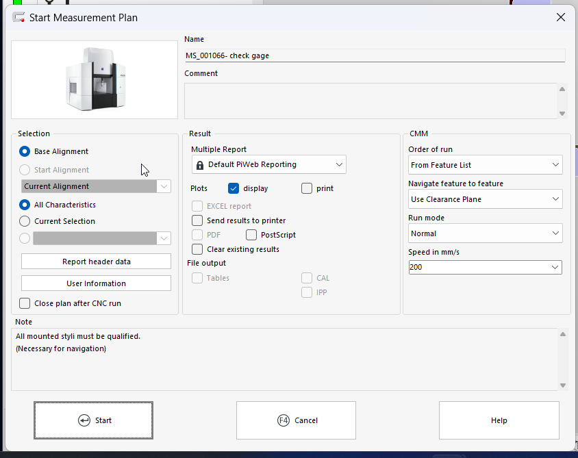

[Da...] Posted July 10 Share Posted July 10 I have a program that has worked just fine in the past. However, today, I bring it up and when I go to start it, the base alignment is locked and greyed out to 'current alignment'. As I mentioned, I have used this program several times before with no issue. Other programs brought up today also seem to work as well. is there something that I can look at and change? Link to comment https://qualityforum.zeiss.com/topic/26985-calypso-2025-wont-let-me-change-to-manual-mode/ Share on other sites More sharing options...
[Ra...] Posted July 10 Share Posted July 10 If "Clear existing results" isn't ticked, it will always be set to current alignment. Link to comment https://qualityforum.zeiss.com/topic/26985-calypso-2025-wont-let-me-change-to-manual-mode/#findComment-152723 Share on other sites More sharing options...
[Za...] Posted July 10 Share Posted July 10 Randawgg is correct. Here's a more in depth explanation on the topic - https://portal.zeiss.com/knowledge-base?id=1769596 Link to comment https://qualityforum.zeiss.com/topic/26985-calypso-2025-wont-let-me-change-to-manual-mode/#findComment-152741 Share on other sites More sharing options...
