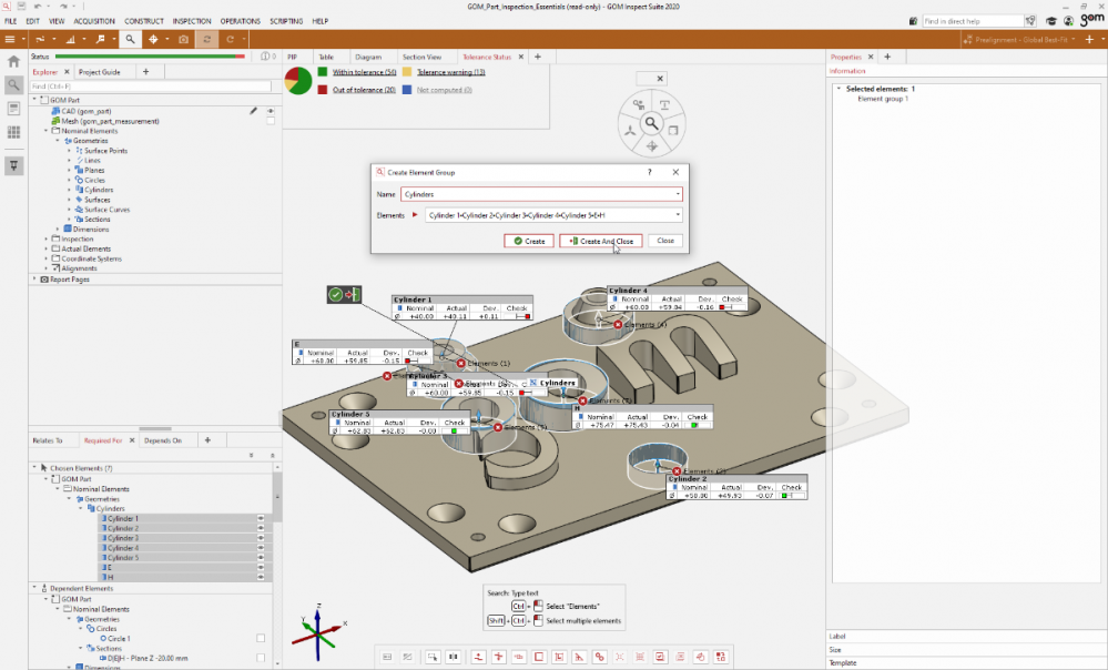

[Na...] Posted December 7, 2020 Share Posted December 7, 2020 I want to know how many of the cylinders on my part are in tolerance. The tolerance status tab includes every check, not just the cylinders. Link to comment https://qualityforum.zeiss.com/topic/27-how-can-i-check-how-many-of-a-group-of-elements-are-in-tolerance/ Share on other sites More sharing options...

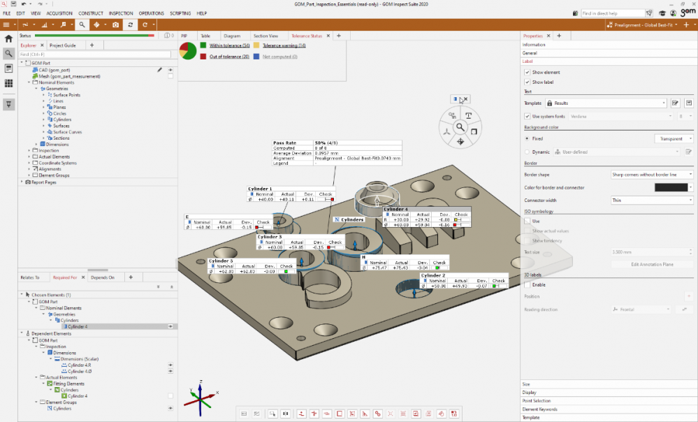

[Na...] Posted December 7, 2020 Author Share Posted December 7, 2020 Select all the elements you are interested in and create an element group with Inspection -> Create element group. Then place an annotation (Inspection -> Create annotation) on the element group's label and change the template to Results. Every check in the element group is then considered and there will be a pass rate displayed in the label. Link to comment https://qualityforum.zeiss.com/topic/27-how-can-i-check-how-many-of-a-group-of-elements-are-in-tolerance/#findComment-68 Share on other sites More sharing options...

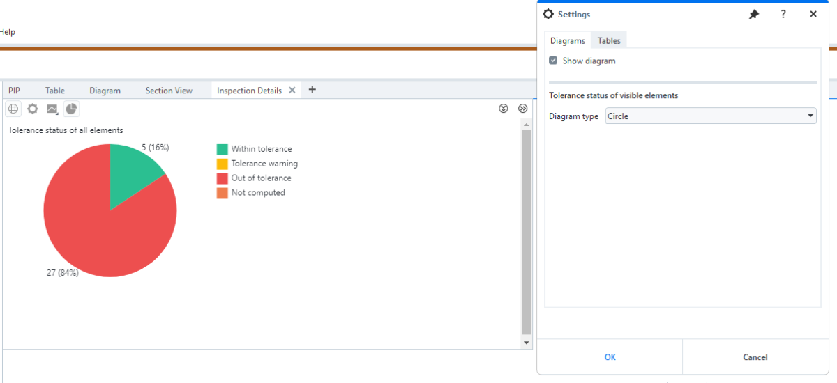

[Al...] Posted April 26 Share Posted April 26 Hello Nanno, looks great, yet i can't find the " Tolerance status tab" ! Link to comment https://qualityforum.zeiss.com/topic/27-how-can-i-check-how-many-of-a-group-of-elements-are-in-tolerance/#findComment-149637 Share on other sites More sharing options...
[Ma...] Posted April 26 Share Posted April 26 (edited) Please sign in to view this username. You can open "Inspection Details" and click on Graph icon - it's not the same, but data are there Edited April 26 Link to comment https://qualityforum.zeiss.com/topic/27-how-can-i-check-how-many-of-a-group-of-elements-are-in-tolerance/#findComment-149639 Share on other sites More sharing options...
[Al...] Posted April 26 Share Posted April 26 Hello Martin, Great, thanks for the support. Link to comment https://qualityforum.zeiss.com/topic/27-how-can-i-check-how-many-of-a-group-of-elements-are-in-tolerance/#findComment-149641 Share on other sites More sharing options...
