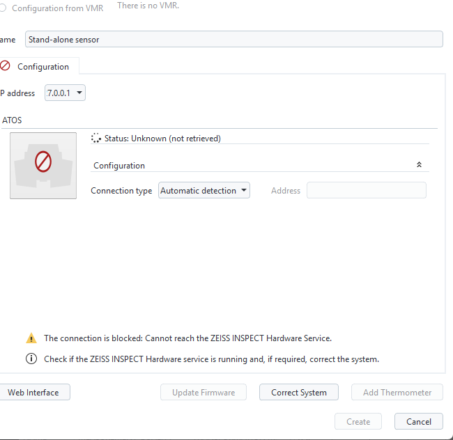

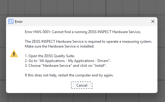

[Sa...] Posted July 16 Share Posted July 16 Hi everyone For some time now I haven't been able to connect to the sensor. I even tried uninstalling the software and it's still the same error. Please, if anyone has the solution. I'm attaching pictures with the errors. Link to comment https://qualityforum.zeiss.com/topic/27023-connection-error-senzor-atos-capsule/ Share on other sites More sharing options...
[Ma...] Posted July 16 Share Posted July 16 I think we have there actual IP address displayed from device. You can try to reboot ATOS. We also had a problem with loose connection. Link to comment https://qualityforum.zeiss.com/topic/27023-connection-error-senzor-atos-capsule/#findComment-152989 Share on other sites More sharing options...

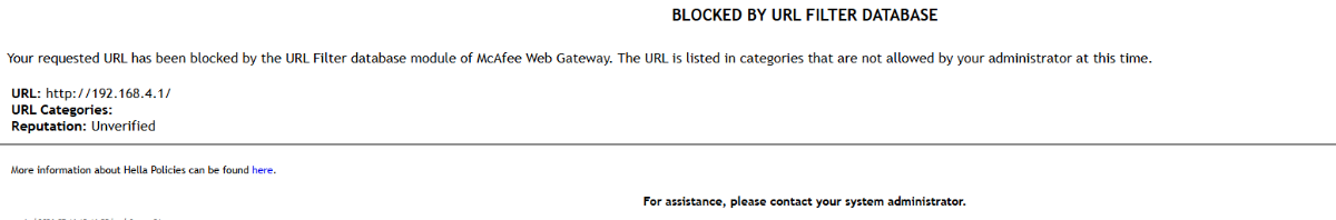

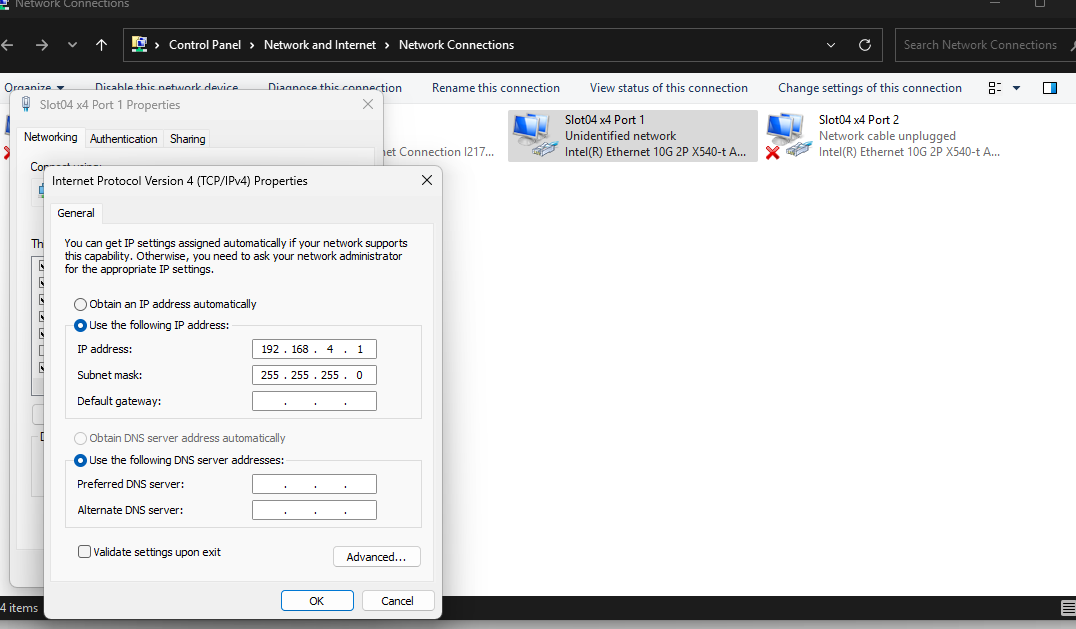

[Sa...] Posted July 16 Author Share Posted July 16 Please sign in to view this quote. I tried and it doesn't work, the connection is enabled, I have all the IPs, and the sensor's IP has restrictions because of the internal network here, and that's the problem, but it worked before. Thanks for the reply! Link to comment https://qualityforum.zeiss.com/topic/27023-connection-error-senzor-atos-capsule/#findComment-152993 Share on other sites More sharing options...

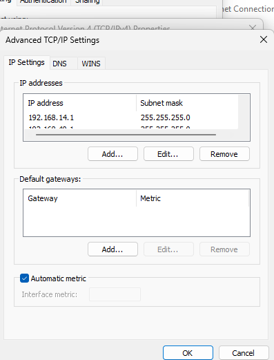

[Ma...] Posted July 16 Share Posted July 16 When we turn on ATOS, then it projects it's IP - this is what we have at hardware setup. Link to comment https://qualityforum.zeiss.com/topic/27023-connection-error-senzor-atos-capsule/#findComment-152995 Share on other sites More sharing options...
[Ma...] Posted July 17 Share Posted July 17 So our setup is like this: bottom IP is projected from ATOS before connecting. Link to comment https://qualityforum.zeiss.com/topic/27023-connection-error-senzor-atos-capsule/#findComment-153041 Share on other sites More sharing options...
