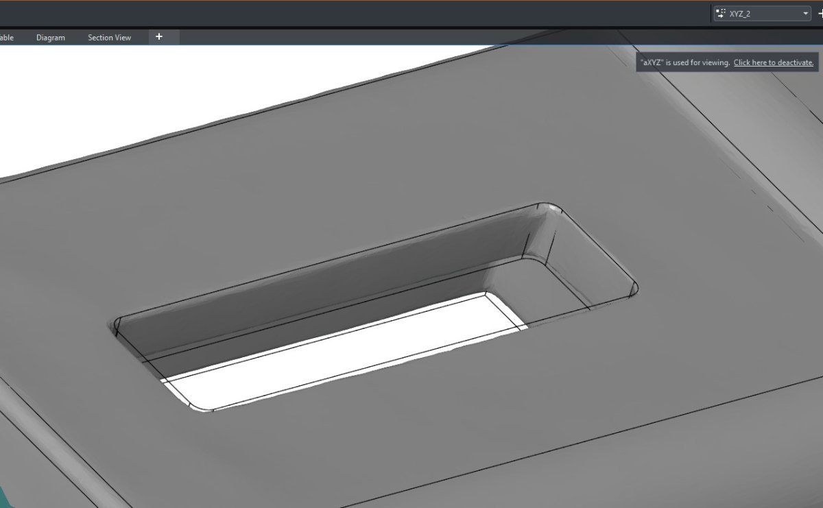

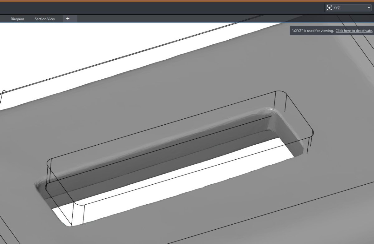

[Jo...] Posted July 23 Share Posted July 23 (edited) Please sign in to view this username. "From your screenshot i can not tell what you are doing, but that seems to me like an overkill." At the moment I am working on a project where i need around 40 local best-fit alignments. I love radii on partial circles with way too tight tolerances and no real function beside not being an edge on a part that is so far off the CAD, that you need to local best-fit everything. Edited July 23 2 Link to comment Share on other sites More sharing options...
[Ma...] Posted July 23 Share Posted July 23 Please sign in to view this quote. Ups, sorry - i have overlooked that those are bestfits on mesh - i thought it was a next RPS - My apologies 👍 Link to comment Share on other sites More sharing options...
[Ma...] Posted July 23 Share Posted July 23 Please sign in to view this quote. Yea definetly , it´s overkill 😂. Many shapes , too large part. 🤘 One of the shape see attachment. 1 Link to comment Share on other sites More sharing options...
