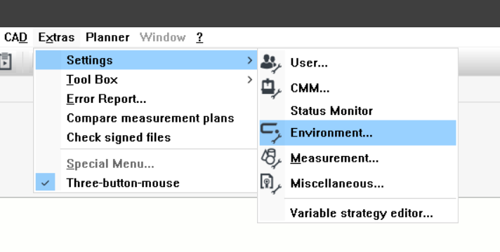

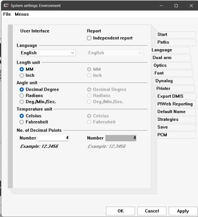

[Ke...] Posted July 22 Share Posted July 22 (edited) What Richard shows in his video (those short videos are a really great way of communicating information clearly) will change the decimal places within that specific measurement plan. You can also change the global setting in Extras-Settings-Environment-Language if that is what you are looking for. Edited July 22 1 Link to comment https://qualityforum.zeiss.com/topic/27061-change-decimal-places/#findComment-153217 Share on other sites More sharing options...
