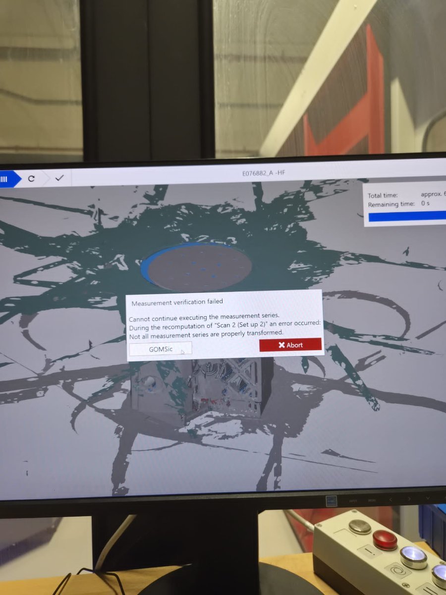

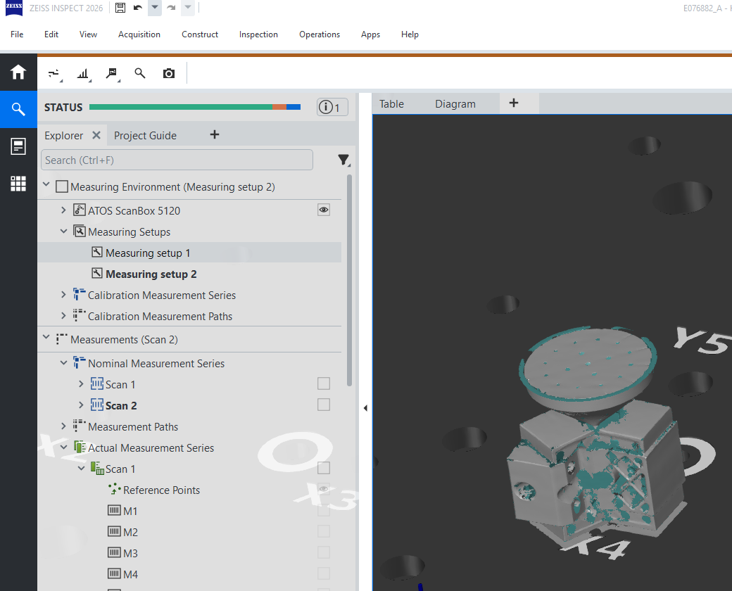

[Re...] Posted July 23 Share Posted July 23 Good afternoon, I made a scanning program that contains two different measuring set ups. I place reference stickers on the item itself. Manually I am able to transform the two measurement series by selecting at least 3 of these reference stickers which are detected in both scans. Real problem is that I am unable to run the project template in Zeiss kiosk. It runs both measurement series but it doesn't gives an option to select the reference stickers to transform them into one mesh and finish the inspection and create report. Is there a solution or a setting which allows this? Is there a solution where I can transform the measurements without using the reference stickers on the part itself so it automatically transform it? Kind regards, Rens Link to comment https://qualityforum.zeiss.com/topic/27071-unable-to-transform-2-measurement-series-automatically-in-zeiss-kiosk/ Share on other sites More sharing options...

[Ch...] Posted July 30 Share Posted July 30 I think you may be missing "Simulated Reference Points" in your "Measurements" compartment. During validation of paths you would have captured reference points which you can then select and go to Construct>Point Cloud>Simulated Reference Points. I'm no expert here just a bit of what I remember from the VMR training I got last year. 1 Link to comment https://qualityforum.zeiss.com/topic/27071-unable-to-transform-2-measurement-series-automatically-in-zeiss-kiosk/#findComment-153738 Share on other sites More sharing options...
[Na...] Posted July 31 Share Posted July 31 Hi, this is possible in Kiosk mode. Make sure to transform the reference points by Acquisition ► Measurement Series ► Transform Measurement Series... If there are reference points not on the part, make sure to have these points as premeasured reference points in the project, so it is clear which points are on the part and should be used for the transformation of the measurement series. In most cases it is easier and faster to build a measuring setup, where the sensor has access to both sides without turning the part manually in the scanning process. Nanno 1 Link to comment https://qualityforum.zeiss.com/topic/27071-unable-to-transform-2-measurement-series-automatically-in-zeiss-kiosk/#findComment-153748 Share on other sites More sharing options...
