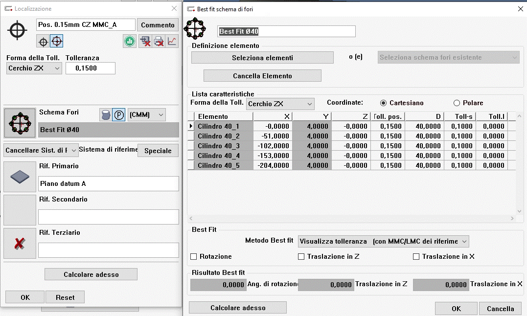

[ni...] Posted July 31 Share Posted July 31 There is a CZ, so do a localisation / best fit, select the 5 cylinders, and the plan A as datum, and check translation and rotation alowed 1 Link to comment https://qualityforum.zeiss.com/topic/27136-true-position-cz/#findComment-153752 Share on other sites More sharing options...

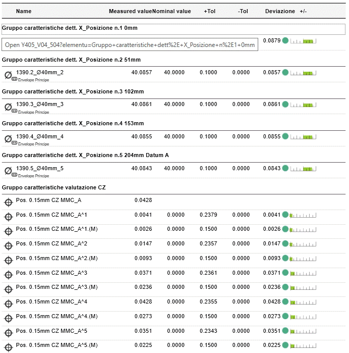

[El...] Posted July 31 Author Share Posted July 31 Okay. This is what I did. I'm attaching the settings (is it correct?) and the results, but I'm not clear about the report results. Thanks Link to comment https://qualityforum.zeiss.com/topic/27136-true-position-cz/#findComment-153762 Share on other sites More sharing options...
[ni...] Posted August 24 Share Posted August 24 Hi, back to work after holidays :) to do a best fit, you have to check the three box (Rotation and translation Z & X) (like you did it's the equivalent of 5 separate true position) Link to comment https://qualityforum.zeiss.com/topic/27136-true-position-cz/#findComment-154600 Share on other sites More sharing options...
[El...] Posted August 25 Author Share Posted August 25 Hi, ....(like you did, it's the equivalent of 5 separate true positions) Yes, I'm aware of that. The three boxes cannot be selected simultaneously: X translation OK Z translation OK or just Rotation and Translation In all cases, the result is always the 5 positions. This CZ is driving me crazy.... Thanks anyway Link to comment https://qualityforum.zeiss.com/topic/27136-true-position-cz/#findComment-154686 Share on other sites More sharing options...
[ni...] Posted August 25 Share Posted August 25 (edited) Hi, maybe the cause is that you have juste select plan A as datum, try to fully complete the datum (primary secondary and tertiary), you will still have 5 results , but there will be slighty different between rotation/translation check or not. and with full datum, I think you could check the three box. an other way to turn around is to create a secondary alignement, and re-call it in you localisation windows in place to edit primary secondary and terciary Edited August 25 Link to comment https://qualityforum.zeiss.com/topic/27136-true-position-cz/#findComment-154690 Share on other sites More sharing options...
[Ri...] Posted August 27 Share Posted August 27 Once you turn on Rotation, the Translation switches from X/Y individually to Translation that encompasses both - so you will have both checked in this case - Rotation and Translation. Link to comment https://qualityforum.zeiss.com/topic/27136-true-position-cz/#findComment-154838 Share on other sites More sharing options...
