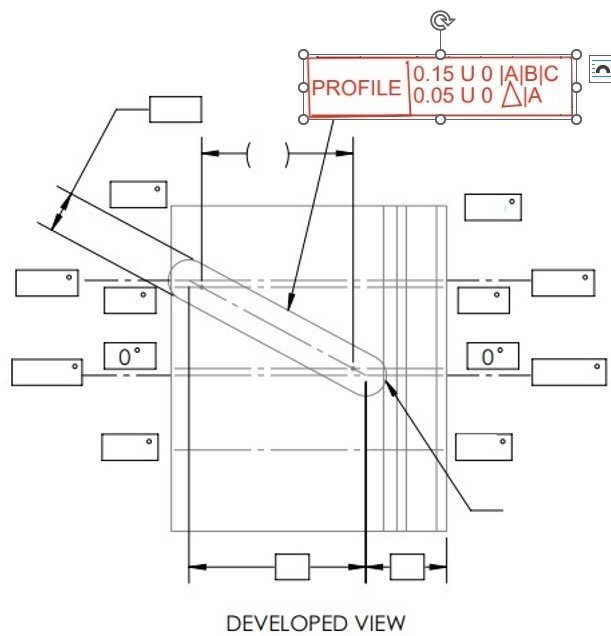

[To...] Posted August 4 Share Posted August 4 (edited) This is the first time I've seen a dynamic profile this and need a little help with setting this up in Calypso 2023. This a marked up drawing so excuse the lack of exactness on the profile callout. I think I'm all set with the upper tier but not sure about the lower tier, especially with the unequal distribution. Any feedback would be greatly appreciated. Edited August 4 Link to comment https://qualityforum.zeiss.com/topic/27170-dynamic-profile/ Share on other sites More sharing options...

[Ed...] Posted August 7 Share Posted August 7 I am also trying to understand dynamic profile, but here are my thoughts: Based on the description of dynamic profile tolerance zone on page 244, I don't think it makes sense to have an unequal disposed tolerance zone. To get the result, i would use Profile with Bilateral-two results. Then report the difference between the min and max. Link to comment https://qualityforum.zeiss.com/topic/27170-dynamic-profile/#findComment-154098 Share on other sites More sharing options...
[Di...] Posted August 13 Share Posted August 13 (edited) Regarding the comment of the OP I think here we have kind of a problem in the specification. 0,05 U0 tells us that the toleranced shape is not allowed to be larger than nominal (limiting size and form as well). So the tolerance zone expands entirely into the material. In contrast to this the triangle symbol allows an offset zone where the size is no longer to be considered for the profile and must be otherwise limited e.g. by a dimension. So the question arising out of this: What is the intention of the designer? Shall the size be limited by the U0 or completely be opened in terms of size (not form) with the triangle symbol? Of course in both cases the distance between the boundaries remains the same but the location of the resulting zone can be something completely different. In my opinion we see here a contradiction in the specification which should be clarified to get rid of the ambiguity. By the way this is not supported in CALYPSO and we are happy to add the dynamic profile as a software request. The dynamic zone is called Offset Zone in ISO and used with the OZ modifier Edited August 13 2 Link to comment https://qualityforum.zeiss.com/topic/27170-dynamic-profile/#findComment-154240 Share on other sites More sharing options...
[Aa...] Posted August 18 Share Posted August 18 I have to agree with Please sign in to view this username. . Tom, you said that you marked up the drawing (I'm guessing for IP confidentiality reasons), but I'm also guessing you didn't add the 'Ⓤ0' to the 0.05 for the line with the Dynamic profile tolerance modifier. If I'm correct in that, and the original print said 0.05Ⓤ0△ on one line, the 'Ⓤ0' contradicts the '△', meaning the designer has not utilized the dynamic profile tolerance modifier correctly. If, on the other hand, the line is actually 0.05△, then this could be the same concept as the example in Figure 11-37 of the 2018 standard, in which a wider-tolerance-zone profile is used to control the size and location of the surface, and a narrower-tolerance-zone dynamic profile is used to control the form. (The example in the standard is explicit in the caption that it is a two-single-segment profile tolerance. I don't even see anywhere the standard addresses the possibility of performing refinements in a composite profile tolerance FCF, though I can see why one might want to do that.) Link to comment https://qualityforum.zeiss.com/topic/27170-dynamic-profile/#findComment-154430 Share on other sites More sharing options...
