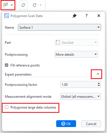

[Ma...] Posted August 6 Share Posted August 6 (edited) I wonder - have you tryied "Polygonize large data volumes"? It should handle such situations. Edited August 6 Link to comment Share on other sites More sharing options...
[Pa...] Posted August 12 Author Share Posted August 12 No, I haven't tried "Polygonize large data volumes". Would you mind show me where I can find that setting? About the stationary pc I've configured on Dell's website, it's a Ultra 9 285K with 128GB of RAM, a RTX PRO 4000 and 2 TB storage. Link to comment Share on other sites More sharing options...
[Ma...] Posted August 12 Share Posted August 12 It's in parameters when you do polygonizing - unpack options in polygonizing window and there it is. Link to comment Share on other sites More sharing options...

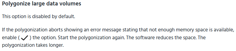

[Pa...] Posted Friday at 05:58 AM Author Share Posted Friday at 05:58 AM I've been scanning for a couple of days and while doing that, I searched for the setting and it is not available for the hawk2. Link to comment Share on other sites More sharing options...
[Ma...] Posted Friday at 07:10 AM Share Posted Friday at 07:10 AM Please sign in to view this quote. Link to comment Share on other sites More sharing options...
[Jo...] Posted Friday at 07:22 AM Share Posted Friday at 07:22 AM You only need it if you run out of memory. Link to comment Share on other sites More sharing options...
