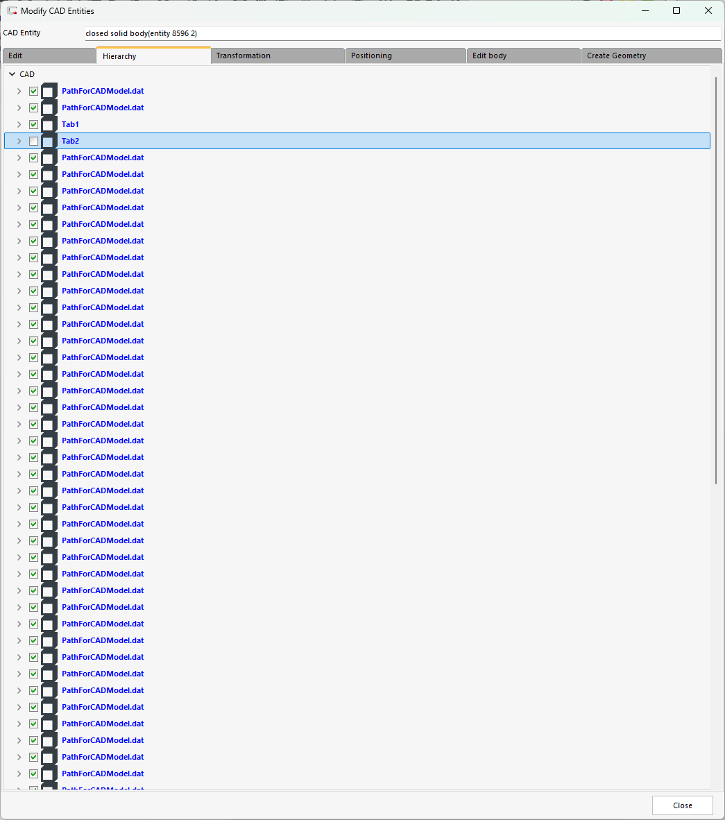

[Sh...] Posted August 14 Share Posted August 14 We've been seeing this consistently since upgrading to SP4. While working in the CAD window, surfaces, edges, or other entities will suddenly disappear for no apparent reason. Sometimes changing the view, rebuilding, or reopening the CAD model brings them back, but the issue keeps coming back. A few things we've noticed: Happens on multiple parts and CAD models. Doesn't seem tied to any specific action. Missing entities are not actually deleted, just no longer displayed. Reopening the file may temporarily fix it. The issue is frequent enough that it's becoming a real frustration during programming. At first, I thought it was something specific to a CAD file, but after seeing it across multiple jobs, it feels more like a bug in SP4. Just wondering if others are seeing the same thing and if anyone has found a workaround or heard anything from ZEISS about a fix. Link to comment https://qualityforum.zeiss.com/topic/27238-calypso-2025-sp4-cad-entities-randomly-disappearing/ Share on other sites More sharing options...

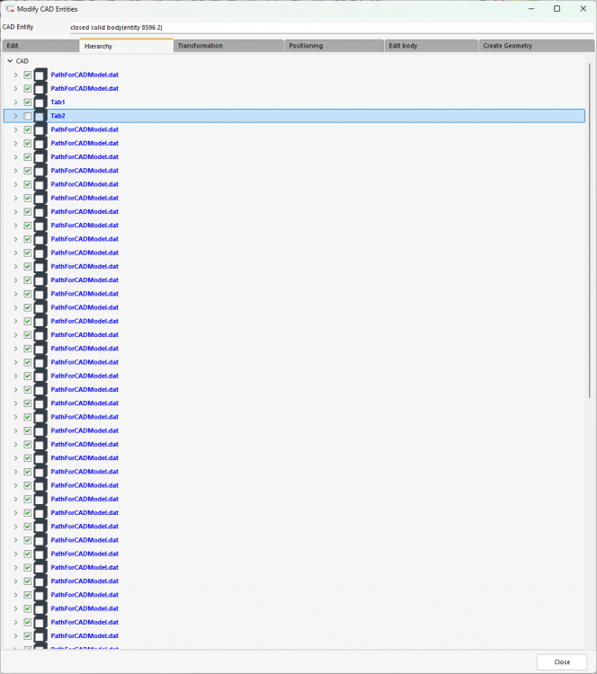

[Sh...] Posted August 18 Author Share Posted August 18 (edited) I want to add more details to help eliminate any confusion. I renamed two of the CAD entities to Tab1 and Tab2, which correspond to tabs located on my CAD model. After I make changes to the measurement plan, all CAD entities occasionally disappear. When this happens, I can no longer toggle the associated features to show or hide them. Sometimes restarting the measurement plan resolves the issue, but in most cases it does not. Before: After: Edited August 18 Added image Link to comment https://qualityforum.zeiss.com/topic/27238-calypso-2025-sp4-cad-entities-randomly-disappearing/#findComment-154434 Share on other sites More sharing options...

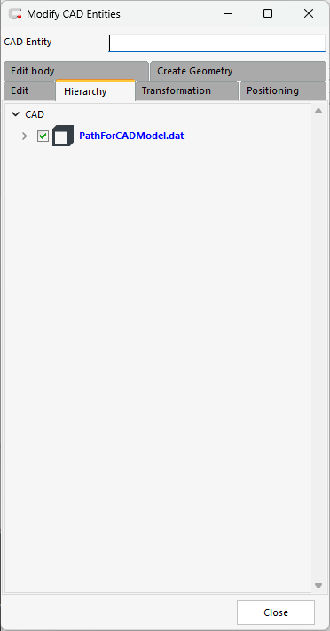

[Ma...] Posted August 24 Share Posted August 24 Hi Please sign in to view this username. this behavior is kind of new within CALYPSO 7.8/8.0 (it started with a ServicePack in 7.8 as far as i know) For internal calculations CALYPSO needs to combine Models which represent your workpiece. You need 1 "file" as your actual workpiece, the others (fixture etc.) need to be unchecked, then they wont be combined with the workpiece file: That merge happens when you define a point/freefrom or when the measurement plan is saved and it cannot be undone! Development is currently working on a better solution for this. Best Regards Marcel Link to comment https://qualityforum.zeiss.com/topic/27238-calypso-2025-sp4-cad-entities-randomly-disappearing/#findComment-154596 Share on other sites More sharing options...
