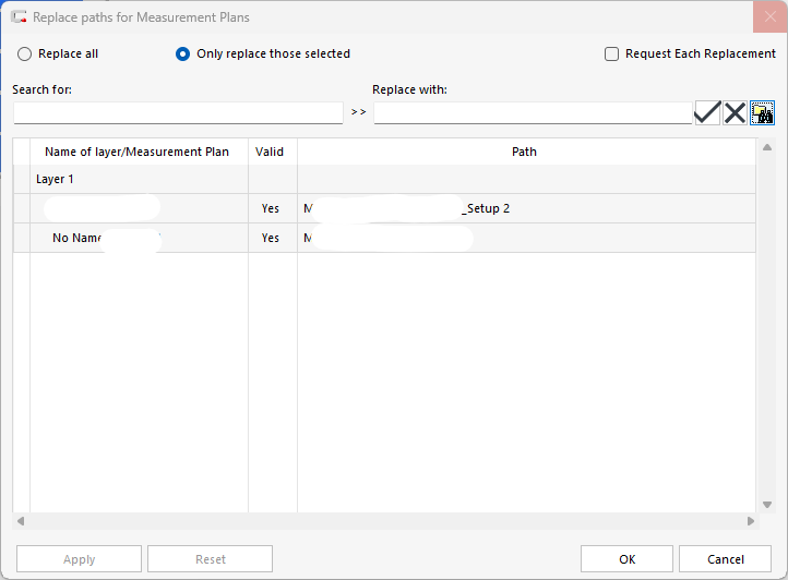

[Ri...] Posted August 20 Share Posted August 20 (edited) I am undergoing a path change for our Autorun programs, the path before was about 7 subfolders deep and will become 3 subfolders deep. Example: C:\Zeiss\Company Name\Programs\Another sub folder\Another sub folder\And another sub folder\Geezus\PCM Programs Will now be: C:\Inspections\PCM Programs I came up with the idea of editing the paths in the arn file, this was easy to do. Then I set my Calypso default paths accordingly in settings. When I opened the new Autorun arn file, all the paths were exactly as original, I confirmed the edited the paths in the arn file. Regardless of the path edits, I had to manually change all the paths in the Autorun system, which is a cumbersome task when you have 100's upon 100's of programs in different layers. Where else are the paths being saved for Autorun arn paths? There has to be another file or more to look at. Edited August 20 1 Link to comment Share on other sites More sharing options...
[Ri...] Posted August 20 Share Posted August 20 Inside of AutoRun - go to Edit - Replace paths for Measurement Plans. There is a much more effective way of quickly changing folder structures. 🙂 2 1 Link to comment Share on other sites More sharing options...
[Ri...] Posted August 20 Author Share Posted August 20 I have found using that interface was hit or miss. I have created the change and Clicked on the Check Mark and watched nothing change. This is why I attempted editing the arn file. 1 Link to comment Share on other sites More sharing options...

[Th...] Posted August 20 Share Posted August 20 There shouldn't be any other path locations. I have manually edited the arn file before in addition to the path replacement tool without issue. I even made a copy of my arn file just now to change one arbitrarily as a test and confirmed that the change carried over to Autorun. Link to comment Share on other sites More sharing options...
[Ma...] Posted August 21 Share Posted August 21 In ARN file there is this [PATH :\inspections\Program 1] And also this [PARAMETERS :add: (#path -> 'C:\Users\Public\Documents\Zeiss\CALYPSO\workarea\inspections\Program 1'); So i think that "PARAMETERS" is more important than "PATH" Link to comment Share on other sites More sharing options...
[No...] Posted August 24 Share Posted August 24 I always did mass changes like this directly in the *.arn file, since the official path dialog is quite cumbersome and long paths are very difficult to handle. So I can cofirm there is no alternative place of storage, but you need to take care of which paths you edit, especially if it is a rather old and grown *.arn file. Apart from the paths listed by Martin, there may also be a variable #nameOfFile containing a path setting. I don't remember which was the crucial one. If you have images loaded to icons, there's also a path line starting with "PICTURE PATH" Link to comment Share on other sites More sharing options...

[No...] Posted August 27 Share Posted August 27 The settings-per-user assumption is correct. We use a workaround where Autorun doesn't start automatically, but as soon as an operator opens it, the *.arn is automatically loaded. To set this up, we first make the setting as shown in the screenshot above (with path to *.arn entered), then switch back to "Start with Calypso". Now when Autorun is called, it automatically loads the *.arn from the path field. All of this has to be set up idividually for each user. And there are numerous occasions where the setup is reset for some reason, like after certain updates or so. 1 1 Link to comment Share on other sites More sharing options...
[Ri...] Posted August 27 Author Share Posted August 27 This explains the reason for this entire post (Read my initial post). Thanks to all. Link to comment Share on other sites More sharing options...
