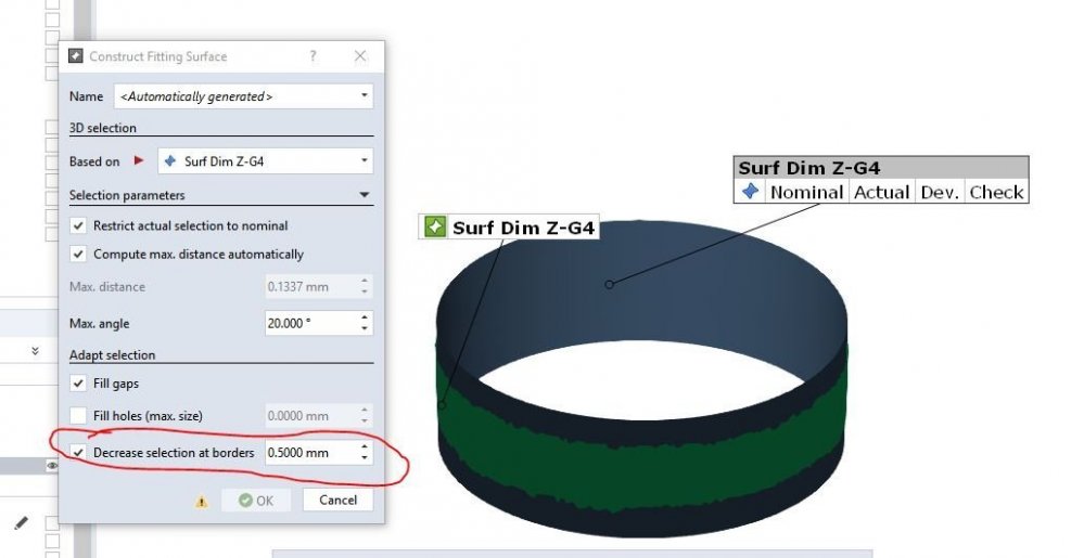

[Vi...] Posted March 9, 2023 Share Posted March 9, 2023 Hello I wonder how can i decrease only on side of the borders when you calculate surface instead of decreasing both at the same time. Best regards Mr. Carro Link to comment https://qualityforum.zeiss.com/topic/2727-help-needed-decrease-only-on-side-of-the-borders-when-you-calculate-surface/ Share on other sites More sharing options...

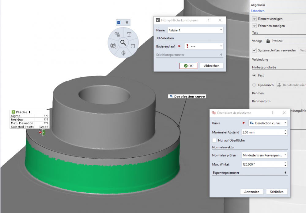

[Na...] Posted March 9, 2023 Share Posted March 9, 2023 Hello Victor, this is not possible in this dialog, but you can chose a deselection tool of your choice to achieve this. For example deselect by curve: Regards, Nanno Link to comment https://qualityforum.zeiss.com/topic/2727-help-needed-decrease-only-on-side-of-the-borders-when-you-calculate-surface/#findComment-7135 Share on other sites More sharing options...
