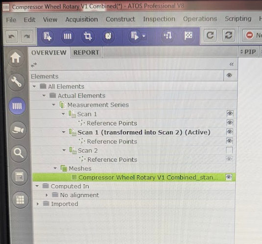

[Ch...] Posted August 24 Share Posted August 24 This might be a beginner question, But I have 3 separate measurement measurement files I want to stitch together and I'm having problems. I fully understand how to combine a top and bottom scans using common reference points. But when I try to import the 3rd scan, it won't let me choose different reference points to stitch that 3rd scan to the two I've already combined. I feel like its something obvious I'm missing here. I can provide more details and screenshots if needed. Link to comment https://qualityforum.zeiss.com/topic/27272-stitching-3-measurement-files-together/ Share on other sites More sharing options...

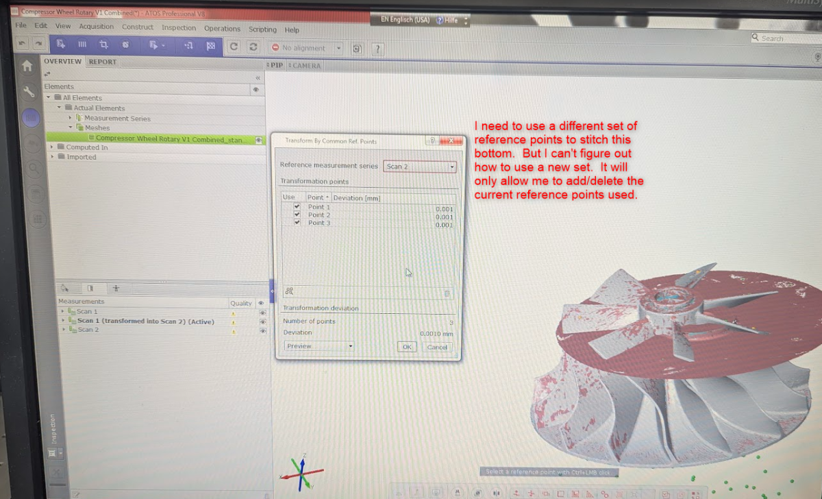

[Ch...] Posted August 24 Author Share Posted August 24 Please sign in to view this quote. This is zeroing in on my issue. Each measurement series is in a separate project. You are correct in that I created the reference point alignment, and Inspect is expecting my 3rd scan to use the same reference point alignment, but it doesn't. It seems like this should be possible, but I can't figure it out. I have an idea of combining two of them using reference points, then turning it into CAD, and then using geometric alignments to combine them, but it seems like I should be able to do this with reference points. Below is a breakdown of what I have: Link to comment https://qualityforum.zeiss.com/topic/27272-stitching-3-measurement-files-together/#findComment-154632 Share on other sites More sharing options...
[Ra...] Posted August 24 Share Posted August 24 Based on your diagram, I think the issue is that the Bottom and Top scans don't share any common reference points. Once Bottom + Middle are aligned using one reference point constellation, the software expects additional datasets to use that same constellation. My thought would be to use the Middle scan as the bridge: Align Bottom ↔ Middle using their common reference points. Keep the Middle scan in the project. Import the Top scan. Create a second reference point alignment between Middle ↔ Top using their shared reference points. In theory, this should allow the transformation chain to propagate Bottom → Middle → Top without requiring Bottom and Top to share reference points. If that isn't possible in ATOS Professional V8, could you share a screenshot of the project tree after combining Bottom and Middle? That should help determine whether this is a workflow limitation or a project setup issue. Link to comment https://qualityforum.zeiss.com/topic/27272-stitching-3-measurement-files-together/#findComment-154634 Share on other sites More sharing options...
[Ch...] Posted August 24 Author Share Posted August 24 Please sign in to view this quote. Okay, this was my idea at first; But I can't figure out how to create a second reference point alignment. Usually I can get these in two scans. So I don't have much practice combining when I use 3 scans. Link to comment https://qualityforum.zeiss.com/topic/27272-stitching-3-measurement-files-together/#findComment-154636 Share on other sites More sharing options...
[Ch...] Posted August 24 Author Share Posted August 24 For reference, I'm going to Acquisition>Measurement Series>Transform by common reference points. Link to comment https://qualityforum.zeiss.com/topic/27272-stitching-3-measurement-files-together/#findComment-154638 Share on other sites More sharing options...

[Ra...] Posted August 24 Share Posted August 24 Please sign in to view this quote. Based on your screenshots, I think you've hit a limitation of the Transform by Common Reference Points workflow in ATOS Professional V8. Once Scan 1 is transformed into Scan 2, V8 appears to expect any additional scans to use that same reference point constellation. Since your Bottom and Top scans don't share common reference points, I'd try importing all three scans into a fresh project before performing any transformations. Otherwise, you may need to use the Middle scan as a bridge or use a geometric alignment for the final merge. I'm not sure whether V8 supports chaining multiple independent reference point transformations, so I'd be interested to hear if anyone has successfully done this in V8. Link to comment https://qualityforum.zeiss.com/topic/27272-stitching-3-measurement-files-together/#findComment-154648 Share on other sites More sharing options...

[Ch...] Posted August 25 Author Share Posted August 25 Figured it out guys. I had to switch my Active measurement series to the one I wanted to transform. This was probably obvious to anyone with more GOM experience, but I'm learning on the fly here. 2 Link to comment https://qualityforum.zeiss.com/topic/27272-stitching-3-measurement-files-together/#findComment-154726 Share on other sites More sharing options...
