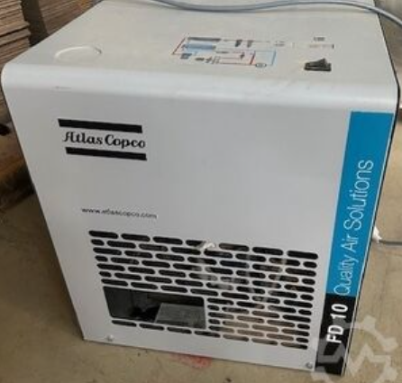

[Ün...] Posted August 26 Share Posted August 26 After encountering the same problem, we also purchased air dryers to go with our CMM devices. We have a single system for both devices, an annual maintenance agreement, and the filters are changed regularly. . Link to comment Share on other sites More sharing options...
