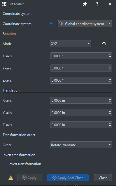

[Ou...] Posted August 31 Share Posted August 31 Hello, I need your help, please. I had to modify my fixture so that I could scan the lower area of my part. Now when I change the 3D of the fixture and move the part to the new position, the alignments (I'm using local best fit) and the features (like points surfaces) don't move with the part. Link to comment https://qualityforum.zeiss.com/topic/27320-moving-the-cad-model-wont-move-the-other-nominal-or-the-alignments/ Share on other sites More sharing options...
[Ma...] Posted September 1 Share Posted September 1 Hi , I solved the same problem some time ago. Move to new 3d data to same global coordinates as original if permissible under the updated data or edit existing elements to new 3d data. Please advise if there is a more efficient alternative available. Many thanks Nice day. 1 Link to comment https://qualityforum.zeiss.com/topic/27320-moving-the-cad-model-wont-move-the-other-nominal-or-the-alignments/#findComment-155032 Share on other sites More sharing options...
[Na...] Posted September 1 Share Posted September 1 Hello, which function did you use to move the part? Is this in a Scanbox with a measuring setup? When you are using a single element transformation make sure to also select the elements and keep in mind that some elements will lose their creation sequence with this function. Operations ► Elements ► Adapt Element To CAD... can help with som elements. Nanno 1 Link to comment https://qualityforum.zeiss.com/topic/27320-moving-the-cad-model-wont-move-the-other-nominal-or-the-alignments/#findComment-155042 Share on other sites More sharing options...
[Ma...] Posted September 1 Share Posted September 1 Hello , I move cad model in free cad. Nice day 1 Link to comment https://qualityforum.zeiss.com/topic/27320-moving-the-cad-model-wont-move-the-other-nominal-or-the-alignments/#findComment-155046 Share on other sites More sharing options...
[Ou...] Posted September 1 Author Share Posted September 1 Please sign in to view this quote. I used the set matrix option, and yes, it is a scanbox with a measuring setup. The Adapt Element to CAD doesn't work. But I did find the solution. Its easy all you have to do is select the CAD and all the Elements that you want to move and then use the set matrix option Link to comment https://qualityforum.zeiss.com/topic/27320-moving-the-cad-model-wont-move-the-other-nominal-or-the-alignments/#findComment-155054 Share on other sites More sharing options...
[Ou...] Posted September 1 Author Share Posted September 1 (edited) Please sign in to view this quote. It's easy; all you have to do is select the CAD and all the elements that you want to move and then use the set matrix option, but you need to recreate the alignment. Edited September 1 Link to comment https://qualityforum.zeiss.com/topic/27320-moving-the-cad-model-wont-move-the-other-nominal-or-the-alignments/#findComment-155056 Share on other sites More sharing options...
