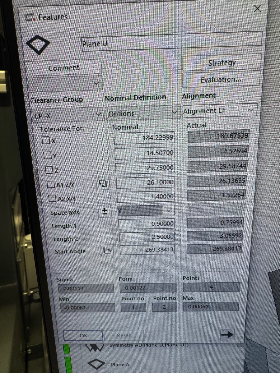

[Yo...] Posted September 1 Share Posted September 1 Hi everybody, I have a workpiece to measure but don't have any CAD model of the part, and then no nominal vectors. I would like to know if it was possible to extract the normal vector of a plane (after probing) and to put the values into the i, j and k vectors of a point feature. That way, I'm sure I'll be measuring with the vector that's normal to the surface. After a plane probing and generation, I just have the angle of it in the alignment (A1 and A2). Thanks Link to comment https://qualityforum.zeiss.com/topic/27338-normal-vector-extraction-from-plan/ Share on other sites More sharing options...

[Yo...] Posted September 1 Author Share Posted September 1 Hi Richard, When you define a plane you have x, y, z and a1, a2. i attached a picture for example . the file you shared is is awesome ! I will try to convert it manually but maybe someone how to proceed automatically in calypso. Link to comment https://qualityforum.zeiss.com/topic/27338-normal-vector-extraction-from-plan/#findComment-155142 Share on other sites More sharing options...

[Er...] Posted September 2 Share Posted September 2 Just add a formula for you points i, j & k. getActual("Plane1").normVector.x /.y /.z Or switch to show vectors if you only wish to see it once? 1 Link to comment https://qualityforum.zeiss.com/topic/27338-normal-vector-extraction-from-plan/#findComment-155176 Share on other sites More sharing options...
[Yo...] Posted September 3 Author Share Posted September 3 Hi Eric, Thank you for your solution. how I can show the vectors X, Y and Z instead of A1 and A2? thanks Link to comment https://qualityforum.zeiss.com/topic/27338-normal-vector-extraction-from-plan/#findComment-155224 Share on other sites More sharing options...
[Mi...] Posted September 3 Share Posted September 3 Please sign in to view this quote. Select Preparation ➝ Features representation or click the icon in the toolbar. Mark the feature before so that the desired geometry is selected. See "Checking or modifying the representation of features" in the manual. Link to comment https://qualityforum.zeiss.com/topic/27338-normal-vector-extraction-from-plan/#findComment-155228 Share on other sites More sharing options...
[Yo...] Posted September 6 Author Share Posted September 6 Hi Mihael, Thank you! Works well 🙂 Link to comment https://qualityforum.zeiss.com/topic/27338-normal-vector-extraction-from-plan/#findComment-155320 Share on other sites More sharing options...
