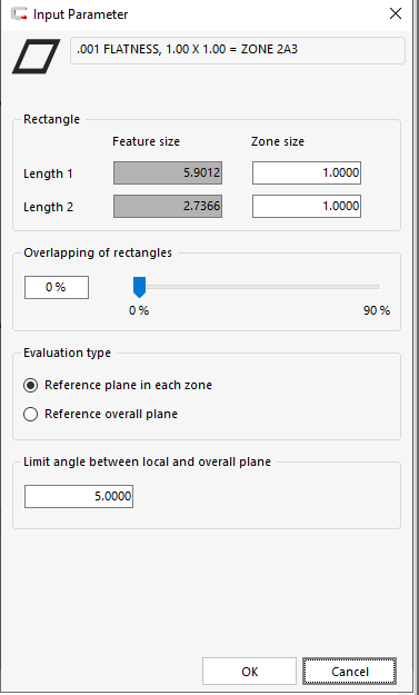

[Ja...] Posted September 1 Share Posted September 1 In the picture below, how would i report the |Flatness|.001/1.00 x 1.00|? In the second pic, you can see the scanning paths I used. Link to comment https://qualityforum.zeiss.com/topic/27342-flatness-question/ Share on other sites More sharing options...

[Ja...] Posted September 1 Author Share Posted September 1 What's the difference between "Reference plane in each zone" and "Reference overall plane" Link to comment https://qualityforum.zeiss.com/topic/27342-flatness-question/#findComment-155122 Share on other sites More sharing options...

[Ja...] Posted September 1 Author Share Posted September 1 How do you decide which option to use? Link to comment https://qualityforum.zeiss.com/topic/27342-flatness-question/#findComment-155126 Share on other sites More sharing options...
[Ma...] Posted September 1 Share Posted September 1 I don't know which one to use, but i got to an explanation: Refference plane in each zone: You evaluate each zone independently - each zone has it's own tilt ignoring others Refference overall plane: It's determined one common plane and then each zone is evaluating only MIN/MAX point inside it's zone ( no tilt per zone ) Link to comment https://qualityforum.zeiss.com/topic/27342-flatness-question/#findComment-155128 Share on other sites More sharing options...
[Ri...] Posted September 1 Share Posted September 1 Your FCF appears to want "Reference plane in each zone" as shown by "1.00x1.00". Reference Plane in Each Zone = .001 per 1.00 × 1.00 Any local 1.00" × 1.00" inspection area must fit within two parallel planes separated by 0.001. This could also mean sometimes you can't construct a 1.00x1.00 zone, maybe you get a .75x1.00 zone, etc. Each zone as closely related to 1.00x1.00 is treated the same. I don't recall having to use the other method. But it seems like each 1.00x1.00 segment must be within ±.0005 within the entire surface used, not just per segment. Another note: The note "A 2 SURFACES" suggests the flatness may apply to two surfaces considered together. You should get clarification on that. This may force you to use the latter description which I believe is stricter than each segment individually. Link to comment https://qualityforum.zeiss.com/topic/27342-flatness-question/#findComment-155130 Share on other sites More sharing options...
[Ja...] Posted September 1 Author Share Posted September 1 Please sign in to view this quote. There is a small (.060 deep x 1.25" long) notch that separates the two planes of Datum A. We machine the entire surface of Datum A with a shell mill prior to any other machining, so I am not too concerned with the "2 SURFACES" being within tolerance. Link to comment https://qualityforum.zeiss.com/topic/27342-flatness-question/#findComment-155136 Share on other sites More sharing options...
