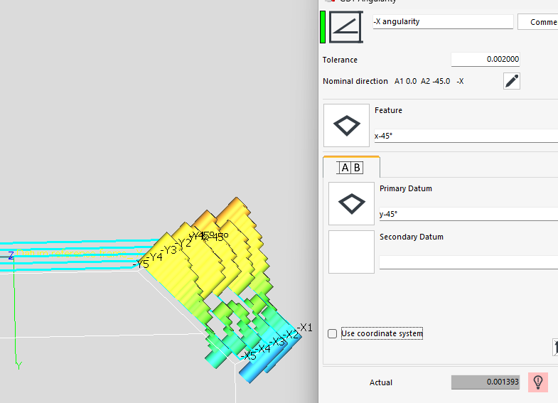

[RP...] Posted September 9 Share Posted September 9 We're having some trouble agreeing on an angle result. Depending on what the other plane is, the CMM measures the angle between 43° - 47° I'm told by the engineer that it's actually a near-perfect 45°. The customer uses a 3d scanner and their results are very close to my cmm results. Is there a super secret way to evaluate angles differently? Here's a visualization of the chamfer's profile. I added random datums to constrain the DoF. 1 Link to comment Share on other sites More sharing options...

[RP...] Posted September 15 Author Share Posted September 15 Please sign in to view this quote. I've tried line to line angle as well, and get nearly the same thing as the plane to plane angle. I'm having a hard time understanding the cad evaluation. Wouldn't the shape of the angle measurement be the same as angularity? I'm also not sure why the cad eval doesn't change color when the characteristic is out of tolerance. I'm doing grid scans on the planes. 1 Link to comment Share on other sites More sharing options...
[Ma...] Posted September 15 Share Posted September 15 Reason I go with line to line is to avoid as much of form error as possible.... Unless features are large enough faces to be considered planes. If you need to continue scanning the planes, then I would make sure that your planes filter out the form errors properly as well as use LSQ eval instead of Outer Tangential. For CAD Eval: Once you set it click on a different characteristic and then back on the one you wanted to look at. Also make sure that you have "color gradient" turned on. Angularity itself is checking the form and orientation of the face compared to the nominal angle. It is no different than checking parallelism (form/orientation at 0°) and perpendicularity (form/orientation at 90°), everything in between those two angles falls under angularity. If the callout is a simple chamfer check, then doing grid scans and checking the form/profile is probably overdoing it.... I would try to picture it as if you set the part on the comparator how would you check/verify your result and then have CMM mimic that. 1 Link to comment Share on other sites More sharing options...
[Je...] Posted September 16 Share Posted September 16 Hi Please sign in to view this username. . It looks like you've really been diligent on analyzing this problem. I like the form plots. Regarding your two last questions: 1. "Wouldn't the shape of the angle measurement be the same as angularity?" That's an understandable assumption. However, no, the shape of the scanned deviations for an angular measurement are fundamentally different from those in a GD&T angularity characteristic. The reason for this relates to the shape of the tolerance zones. Angularity establishes a linear tolerance zone that is controlled by a basic angle driven by the datums. In the case of your chamfer feature, the shape of the tolerance zone is two parallel planes. The .001064 deviation is the quantity of linear deviation from the center of that coplanar tolerance zone. Regarding colors: The magnitude (farther or closer from nominal) of deviations in the angularity characteristic will assign the color gradient based on departure from the coplanar tolerance zone. 2. "I'm also not sure why the cad eval doesn't change color when the characteristic is out of tolerance." The way that the color gradient in Calypso angular characteristic should be assigned is in an arc-shaped path relating to the angle. However, for angle measurement, all we get is a form plot that shows us the form deviation of the two features of interest. This is why there is no color gradient assigned, and it's all green. This CAD evaluation is still useful; however, because it shows you how the planes are calculated according to their form error, and significant form error can be a signal for out-of-tolerance results. I hope that answers those two questions. Chamfers are important features that are often downplayed as "simple." Also, the evaluation algorithm that is assigned to each of the features that construct your chamfer is very important. Outer tangential method will be prone to rocking the planes and introduce high variation in results. If you're using high density scanning, which appears to be the case, LSQ may give you more stable results. Either method may be valid, but it helps to be aware of the effects. Chamfers are also a rare case where I sometimes enable the "constraints" options in the evaluation tab of the features to prompt the characteristic to only consider deviation along vectors that matter functionally. I'm interested to hear how this chamfer measurement problem develops for you. 1 Link to comment Share on other sites More sharing options...

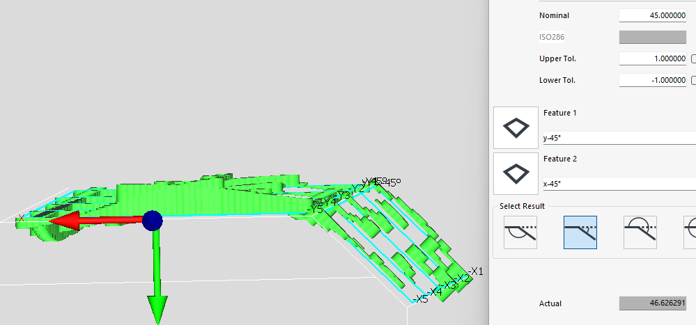

[RP...] Posted September 16 Author Share Posted September 16 I'm lost again attempting more research. The results are in tolerance if the angled feature is constrained, but the cad eval looks warped. The results are out of tolerance if neither are constrained, but the cad eval looks fine. Link to comment Share on other sites More sharing options...
[Ma...] Posted September 16 Share Posted September 16 For Cone angle I would capture the cone with either line scans or helix path with start/stop about 20-30% from the edges. (this is to avoid surface finish from affecting angle readings) Second thing automatically go and constrain normal vector for the cone in the feature evaluation and then just report either cone angle (included) or half cone angle If you constrain the chamfer plane (it constrains it normal to the alignment it was captured in to say it's perfect to that alignment) then you are essentially checking your top plane to the alignment of the part. The cad eval issue might be the magnification factor way too high (or possibly set to auto) 1 Link to comment Share on other sites More sharing options...

[RP...] Posted September 18 Author Share Posted September 18 Please sign in to view this quote. I have, and match the CMM and Keyence results. And the customer's results. Our engineers think the planes need to be constrained. Even though I've never had to constrain a plane before. I'm scanning and evaluating this thing muuuuultiple ways. The results are always similar. Part of me want's to believe the engineer because the cad eval shows the points within their zones. But constraining the features, and the result is conforming. But the eval looks non-conforming. However earlier this week, Jeff informed me about angles showing form instead of result. That would mean the form is good and the measurement is accurate? And Marcel was saying 'when constraining the angled features, the form is compared to the alignment.' So the constrained view is what the part looks like? buuuut measures the angle in tolerance. non-constrained: constrained: Link to comment Share on other sites More sharing options...
[Ma...] Posted September 18 Share Posted September 18 That "constrained" picture seems like wrong nominal vector - that second picture is not showing correct 45° I would believe that "non-constrained" is constrained. How you got to show this image. By "Form" or profile? Link to comment Share on other sites More sharing options...
[RP...] Posted September 18 Author Share Posted September 18 They're just angle characteristics. The cad eval is enabled with tolerance Windows. The angle is oot. So the top image results are correct. I was expecting the top image to look like the bottom image. Link to comment Share on other sites More sharing options...
[Ma...] Posted September 18 Share Posted September 18 How big is magnification? 200? I rather use cylinders than those points. So all features are having correct nominal vector and same feature's alignment, right? Link to comment Share on other sites More sharing options...
[RP...] Posted September 21 Author Share Posted September 21 Mag 80. And Correct, same alignments and vectors. Below images are with mag 25 and Ø.005 cyls. Link to comment Share on other sites More sharing options...
[Ma...] Posted September 21 Share Posted September 21 Thanks. I think you are very close to the edges - tolerance for that chamfer is still .005? I would scan at least .004 from theoretical edge and only after some bestfit for that area. 1 Link to comment Share on other sites More sharing options...
[Ma...] Posted September 21 Share Posted September 21 Whatever you constrain you are telling Calypso that it's perfectly that..... So if you constrain the 45° face angle you are telling Calypso to report nominal number regardless of what it actually measures..........I was saying that if you capture top face in Alignment 1 and 45° face in Alignment 2 and you constrain both of them and measuring the angle between the two features you are realistically measuring the angle difference between the two alignments, and not the faces you selected. Link to comment Share on other sites More sharing options...
