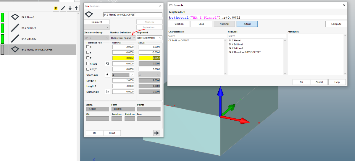

[To...] Posted September 9 Share Posted September 9 My base alignment is a plane on top for Spatial and Z Origin, a circle on top for X & Y Origin and a plane on the right side for planar. We believe the tool that is cutting the top plane is .0052" too deep and affecting some of our compound angle hole measurements. Can anyone explain how to set up the base alignment to make it appear that the top plane is .0052" higher without changing the nominal info of the other features? TIA Link to comment https://qualityforum.zeiss.com/topic/27394-base-alignment-trick/ Share on other sites More sharing options...

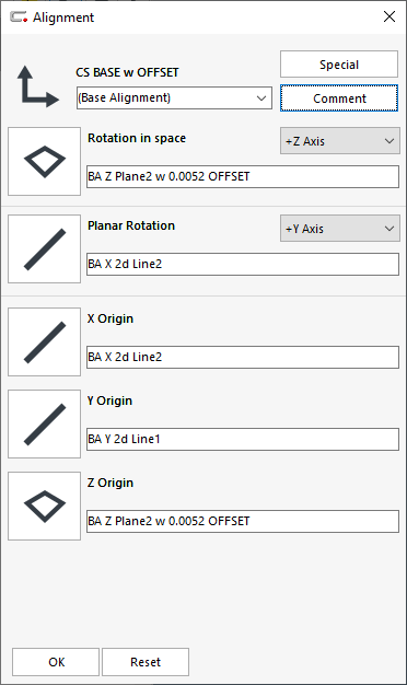

[Ma...] Posted September 10 Share Posted September 10 Never use Base Alignment to measure anything.... Always create secondary alignments.... Create Plane with offset referencing your base plane and how much you want to offset it.... then in secondary alignment use that offset for planar/origin.... then switch those features to use that secondary alignment instead of the base alignment Link to comment https://qualityforum.zeiss.com/topic/27394-base-alignment-trick/#findComment-155486 Share on other sites More sharing options...
[Jo...] Posted September 10 Share Posted September 10 I think this was said above but heres some pictures. Copy your Z plane, make it a theoretical. use GetNominal formula for the nominals & GetActual for the actual Create and alignment same as your base alignment but use the theoretical plane with your offset. 1 Link to comment https://qualityforum.zeiss.com/topic/27394-base-alignment-trick/#findComment-155496 Share on other sites More sharing options...
