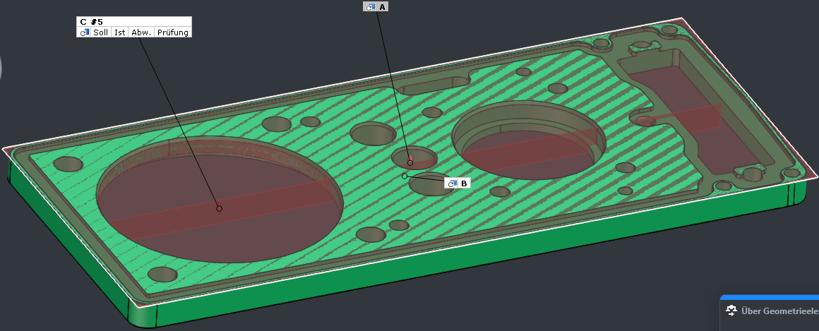

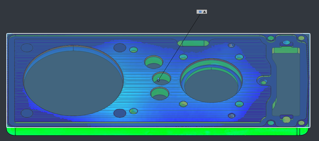

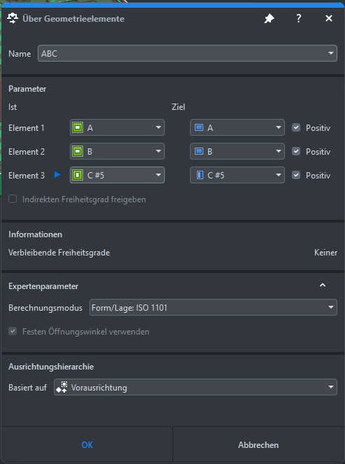

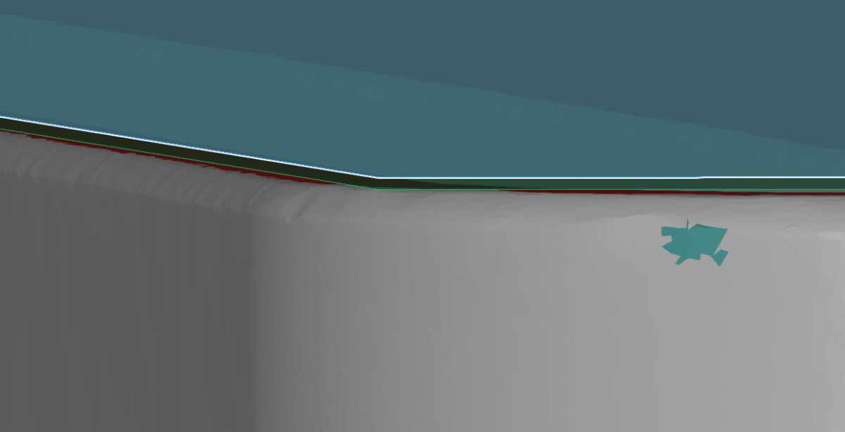

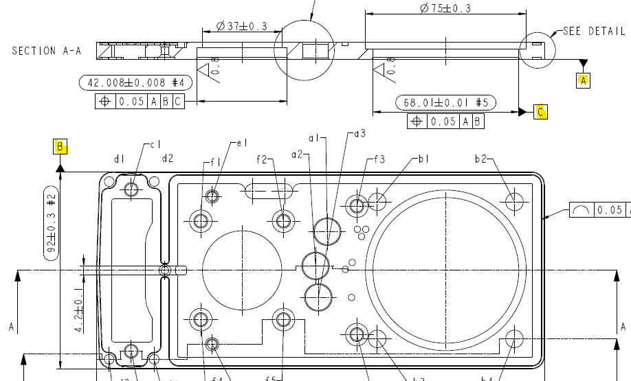

[Jo...] Posted September 10 Share Posted September 10 Hello, i am doing pretty basic stuff and getting unexpected results. I am hoping you might find what i`m doing wrong or confirm that the observed behaviour is not to be expected. Building the datum system i get an parallel offset to the main datum A with the calculation method ISO 1101. With geometry it is looking as expected. Depiction of the "unexpected behaviour": Topview with surface comparison: Sideview: You can clearly see the parallel offset of plane A between part and CAD after aligment. This should not happen in my opinion. The first 3 degrees of freedom of plane A should fix this no matter Geometry or Iso 1101 calculation. Information (drawing and how the datum system is build): Thanks in advance! Link to comment Share on other sites More sharing options...
[Ma...] Posted September 10 Share Posted September 10 If you want to be sure make surface profile for datum A to your ABC, then extract MIN/MAX from all points of profile callout - you should see in MAX 0.000 ISO/ASME makes datum A as tangential element. Link to comment Share on other sites More sharing options...

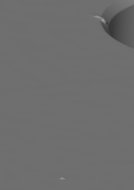

[Jo...] Posted September 10 Author Share Posted September 10 Ok, found the culprits. Got some dust on the part while spraying. just my temporary blindness and working as intended. @Martin i trusted the surface comparision too much and got mislead. the way way you descibe is fool proof, thanks. 1 Link to comment Share on other sites More sharing options...
