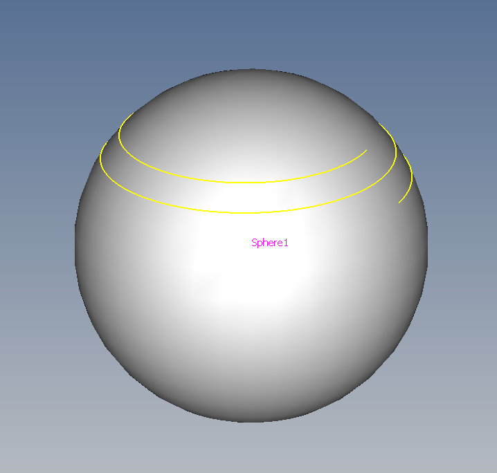

[Ma...] Posted September 17 Share Posted September 17 Hello, Does anybody know any solution to make a probe follow the path without touching the material? I would like to have a helix path around an imaginary sphere (like image below) but I can't create Sphere with strategy "Helix Path", because machine is looking for a material and it ends up stopping the "measurement". The only way of making it work is to create a Point with strategy "CMM position" and formula for X, Y and Z, but machine is moving in "step-mode" (achieve first point and stop, achieve next point and stop) instead of smooth, continuous motion. Link to comment https://qualityforum.zeiss.com/topic/27443-scanning-in-air-without-touching-the-material/ Share on other sites More sharing options...

[Ma...] Posted September 18 Author Share Posted September 18 Please sign in to view this username. Please sign in to view this username. Please sign in to view this username. Yes, I know it sounds weird without context but I need this to automatically clean a probe using this cleaning brush https://shop.metrology.zeiss.de/INTERSHOP/web/WFS/IMT-DE-Site/en_DE/-/EUR/ViewProduct-Start?SKU=626170-0011-655&CategoryName=415000&CatalogID=400000&ExtendedNavigation=true 3 Link to comment https://qualityforum.zeiss.com/topic/27443-scanning-in-air-without-touching-the-material/#findComment-155781 Share on other sites More sharing options...
[Er...] Posted September 18 Share Posted September 18 You can move the probe in a helix motion without measuring. But in this case there is a risk of the brush causing a collision depending on how deep you go. But Im not going to show how to, since I suspect there might be someone that won't like that information out there. How ever, there is no reason at all to do it they way you ask for. Just set the spehere diameter to 50 and scan it. We use randomized startangles and numbers of rotations so it dont drag the probe at the same locations every time. 1 Link to comment https://qualityforum.zeiss.com/topic/27443-scanning-in-air-without-touching-the-material/#findComment-155783 Share on other sites More sharing options...

[Ma...] Posted September 24 Author Share Posted September 24 Please sign in to view this quote. Please sign in to view this username. On top of that sphere there is a "bald" area where you can probe some points to get the center of it. For simple aligning it's enough. Link to comment https://qualityforum.zeiss.com/topic/27443-scanning-in-air-without-touching-the-material/#findComment-156045 Share on other sites More sharing options...
