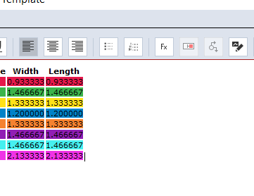

[ca...] Posted March 14, 2023 Share Posted March 14, 2023 Hello everyone, I created a table with pandas dataframe and then try to use it as a label template for storing some values. First, I converted it into html format and then when I try to insert it in GOM with edit label template command, it does not show the colors. However, when i clicked inside the edit template button, I can see the colors in the table automatically. How can i convert the format to see color adjustments directly on the 3D view? Thanks, Canset Link to comment https://qualityforum.zeiss.com/topic/2745-edit-label-template/ Share on other sites More sharing options...
