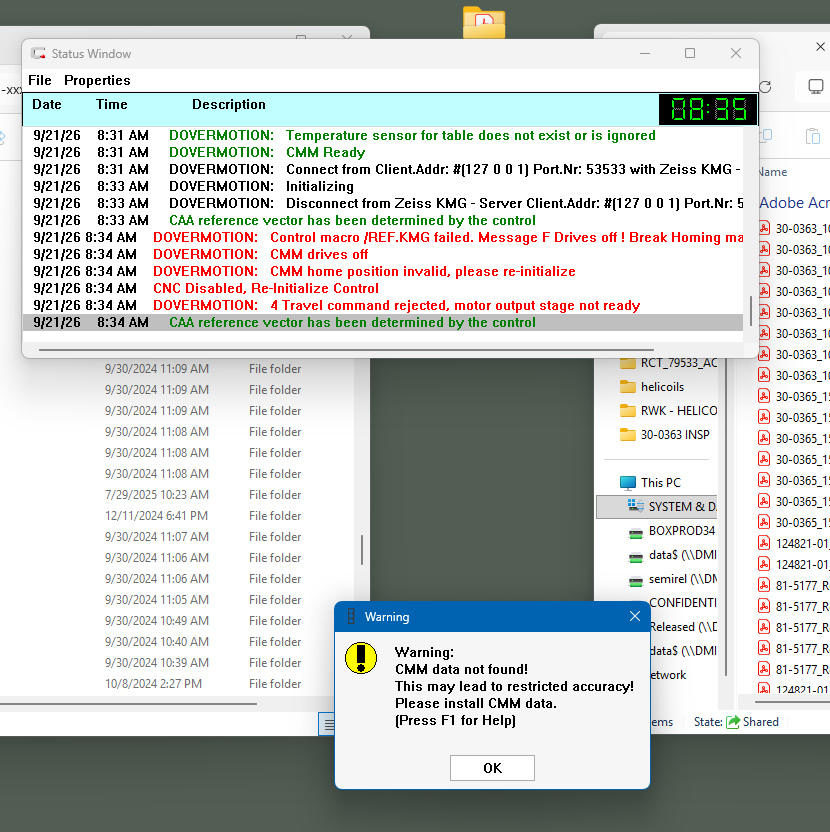

[Si...] Posted September 21 Share Posted September 21 Has anyone seen this, It has been happening... ALOT. Typically after the machine has been shut down fully. It gets to the Homing, The Z drives up, the machine travels back while the X travels to the left... once it hits about 75% of the way to the Machine home, it trips out. I have yet to figure out why because it then randomly just doesn't error out. Its sporadic. Link to comment https://qualityforum.zeiss.com/topic/27455-cmm-data-missing-at-homing-error-constant/ Share on other sites More sharing options...
[Br...] Posted September 21 Share Posted September 21 Hello, You have a controller / hardware issue. Clean the machine ways. if the problem persists, please contact Zeiss Hardware support. Link to comment https://qualityforum.zeiss.com/topic/27455-cmm-data-missing-at-homing-error-constant/#findComment-155879 Share on other sites More sharing options...
[Ab...] Posted September 21 Share Posted September 21 Hello, we have a knowledge base article with steps on how to fix this error Link to comment https://qualityforum.zeiss.com/topic/27455-cmm-data-missing-at-homing-error-constant/#findComment-155881 Share on other sites More sharing options...
[Ab...] Posted September 21 Share Posted September 21 https://portal.zeiss.com/knowledge-base?id=1475168 Link to comment https://qualityforum.zeiss.com/topic/27455-cmm-data-missing-at-homing-error-constant/#findComment-155883 Share on other sites More sharing options...
[Si...] Posted September 21 Author Share Posted September 21 (edited) Ok thanks all. I typically clean the Machine ways if this pops up. I read the Knowledge base and after no luck for an hour, saw that I should try to slow down the machine speed at Homing from a 2023 post. That worked. Did full reboots and shutdowns 3 times prior too. Edited September 21 Link to comment https://qualityforum.zeiss.com/topic/27455-cmm-data-missing-at-homing-error-constant/#findComment-155885 Share on other sites More sharing options...
