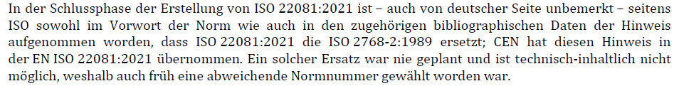

[Ma...] Posted September 25 Share Posted September 25 Please sign in to view this username. How are treated old drawings? For example from year 1996 or even older? For example in 2768-1 there was an table with tolerances ( which could be recommended ) - in newer version it's without this table and it's said this table of tolerances has to be in drawing or customer norm. Link to comment Share on other sites More sharing options...
[Jo...] Posted September 25 Share Posted September 25 (edited) You can not just switch between 2768 and 22081. 22081 is so much more than just general tolerances. When i first read through 22081 i told our engineers (mostly older) that they have to change their way of thinking or they won`t be able to understand a drawing with 22081 and the implications at all. From 22081 (only got this in german) Meaning older drawings still got to use 2768 Edited September 25 Link to comment Share on other sites More sharing options...
