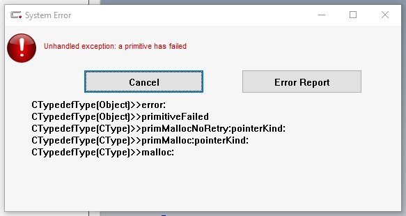

[is...] Posted September 24 Share Posted September 24 One on our cmm is constantly throwing this error after the program is finished and creating PDF file. These programs were running without issue since, until a couple of days ago. And I am getting it also now in my laptop using offline planner. Calypso V.6.8 Anybody know what is causing this? Link to comment https://qualityforum.zeiss.com/topic/27493-error-a-primitive-has-failed/ Share on other sites More sharing options...

[is...] Posted September 25 Author Share Posted September 25 When running the program Report will be generated pops-up then after a while around 5 minutes or so (not normal) then the error pops-up. Background notes: Our IT is working on all company computers regarding access, security, uninstalling old unsecured applications, etc. to be compliant under TISAX certification. Anything that Calypso is using in the background might be moved, deleted or reconfigured might be the culprit, but, I am wondering what that would be. Link to comment https://qualityforum.zeiss.com/topic/27493-error-a-primitive-has-failed/#findComment-156133 Share on other sites More sharing options...
[is...] Posted September 29 Author Share Posted September 29 UPDATE: Background: IT department modified the network printer path/location without us knowing, this caused the error to occur after the program finished running and about to create PDF files and send to print automatically. In the Calypso Environment - the printer was still set-up to the old network printer which was selected initially before. The Fix: changed it to calypso default printer, which is the newly set-up network printer or you can select the printer manually in define printer. Link to comment https://qualityforum.zeiss.com/topic/27493-error-a-primitive-has-failed/#findComment-156267 Share on other sites More sharing options...
