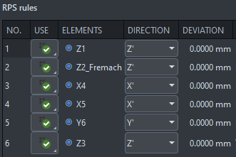

[Ma...] Posted October 1 Author Share Posted October 1 Hello , I change my mind. 🫢🫣 What do you think , is it right ? 1. construct 3 planes from point + normal plane from datum system , X+Y+Z 2. evaluated separately for axis for X+Y+Z + together . Link to comment https://qualityforum.zeiss.com/topic/27523-surface-profile-evaluating-only-one-direction/#findComment-156339 Share on other sites More sharing options...
[No...] Posted October 1 Share Posted October 1 That changes only the datum system, not really the evaluation direction. Link to comment https://qualityforum.zeiss.com/topic/27523-surface-profile-evaluating-only-one-direction/#findComment-156347 Share on other sites More sharing options...
[Ma...] Posted October 1 Author Share Posted October 1 I won´t change datum system , its the same , i used direction of axis X,Y,Z separately by plane from Datum system. Isn´t that true? Link to comment https://qualityforum.zeiss.com/topic/27523-surface-profile-evaluating-only-one-direction/#findComment-156349 Share on other sites More sharing options...
