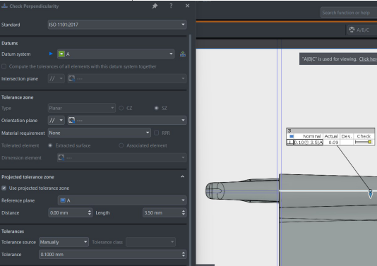

[Be...] Posted September 30 Share Posted September 30 Hi everyone, I could use some help here. I have a drawing that specifies an angularity check with an asymmetrical tolerance zone. How do I inspect this? I’ve already constructed the feature to be inspected and the datum. However, when I try to check the angularity, I can't set an asymmetrical tolerance—like you can for a surface profile, for example. Does this actually work for angularity, or do I need to inspect it differently? Thanks in advance for your help! Link to comment https://qualityforum.zeiss.com/topic/27537-checking-angularity-with-an-asymmetrical-tolerance-zone/ Share on other sites More sharing options...
[Jo...] Posted September 30 Share Posted September 30 (edited) Have you tried the option "projected tolerance Zone"? Have not used this myself, but looks like this would provide the function of an offset tolerance zone. Or not... Edited September 30 Link to comment https://qualityforum.zeiss.com/topic/27537-checking-angularity-with-an-asymmetrical-tolerance-zone/#findComment-156307 Share on other sites More sharing options...

[Be...] Posted October 1 Author Share Posted October 1 Thanks for the feedback. For now, I’ve simply checked it using the specified 90° angle (or perpendicularity) and a standard inclination, without the asymmetric tolerance zone. The projected tolerance zone isn't the right approach here. Link to comment https://qualityforum.zeiss.com/topic/27537-checking-angularity-with-an-asymmetrical-tolerance-zone/#findComment-156369 Share on other sites More sharing options...
[Ma...] Posted October 1 Share Posted October 1 Projected tolerance on TP will result in measuring TP in places, where you can not measure ( typically in assembly ). Projected tolerance for perpendicularity will result in using different length - again for cases you can not measure directly. This is not suitable for using it as UZ. Only thing i would see used is on one of our customer - TP with UZ - it was used with length distance, so we moved TP TED position by that UZ. 1 Link to comment https://qualityforum.zeiss.com/topic/27537-checking-angularity-with-an-asymmetrical-tolerance-zone/#findComment-156421 Share on other sites More sharing options...
