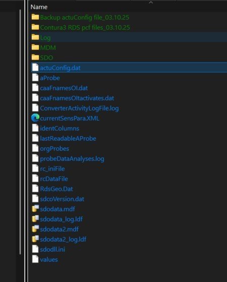

[Ju...] Posted October 1 Share Posted October 1 Hi, I need help with new PC. I done backup of folder in public documents Zeiss and restore this in new PC, license and connection to CMM is also set. But I cant find how to transfer CMM settings for example users etc.. What must be done for backup and where to do that. Thanks for help Link to comment https://qualityforum.zeiss.com/topic/27545-calypso-cmm-backup-and-restore/ Share on other sites More sharing options...
[Ri...] Posted October 1 Share Posted October 1 As an example. These are the files I backup, this particular set is for an RDS system. Link to comment https://qualityforum.zeiss.com/topic/27545-calypso-cmm-backup-and-restore/#findComment-156357 Share on other sites More sharing options...
[Lu...] Posted October 1 Share Posted October 1 Hi Juraj, User information is stored in the ProgramData folder (C:\ProgramData\Zeiss\CALYPSO {version}\users). ProgramData is a hidden folder by default, so you may need to unhide it. All other CMM settings are stored in the config folder in Public Documents (C:\Users\Public\Documents\Zeiss\CALYPSO {version}\config). Link to comment https://qualityforum.zeiss.com/topic/27545-calypso-cmm-backup-and-restore/#findComment-156385 Share on other sites More sharing options...
