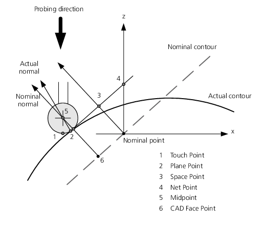

[Pe...] Posted October 2 Share Posted October 2 (edited) Are you clicking points on a CAD model with the "Define points" option? This defaults to the Touch Point evaluation method (snaps vector to nearest coordinate axis) and rounds your nominals to the "Round-off measure" setting under Extras->Settings->Measurement... Instead try the "Define a Space Point" option. This will maintain the nominals from the CAD model and set the evaluation method to Space Point, which also uses the correct vector from the CAD. Edited October 2 4 Link to comment https://qualityforum.zeiss.com/topic/27571-part-not-square-to-coordinate-system/#findComment-156481 Share on other sites More sharing options...

[Je...] Posted October 2 Share Posted October 2 Please sign in to view this username. , hang in there. Your problem is real, but it's solvable. My first CMM gig was measuring large machinery that sounds similar to your current challenge. It's entirely possible to measure parts that are not orthogonally perpendicular to the CMM's coordinate system, including parts without planes and other prismatics. What Peter and Martin suggested regarding space points vs CAD points should solve your point placement issue. There are several different types of points in Calypso. The CAD point option tends to snap points to the CAD entities as though they're magnetic. Space points should work better here, even though the names sound counterintuitive. Regarding the alignment challenge, there are two options I would consider: 1. Non-standard alignment options such as best-fitting / RPS (reference point system). You can use a cluster of points to define your workpiece and constrain degrees of freedom. This works well on parts without prismatic features like planes, cylinders, etc.. 2. Standard alignment with a defined rotational angle from the "Special" menu. If you can create a standard alignment but just need to define that it will be clocked at a known angle, you can use the special button in the alignment window to rotate the alignment by this angle. 1 Link to comment https://qualityforum.zeiss.com/topic/27571-part-not-square-to-coordinate-system/#findComment-156497 Share on other sites More sharing options...
[Be...] Posted October 2 Author Share Posted October 2 Follow up: I got this picture from ZEISS Portal. They make a distinction between the actual normal and the nominal normal. They then draw two points. It looks like they label the plane point as using the actual normal. I would assume that they get that from the force direction applied to the probe. In the text explanation they don't distinguish which of those two normals they are using. They also don't give the second point a name. So which normal vector do they use? Further, if I am using a space point, are they really going to project it out into space like that? Will the software really just screw with the measurement and give you no reasonable answer for what trying to measure the point? 1 Link to comment https://qualityforum.zeiss.com/topic/27571-part-not-square-to-coordinate-system/#findComment-156499 Share on other sites More sharing options...
