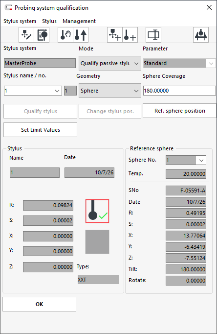

[Ze...] Posted October 5 Share Posted October 5 Hi all, If I put a Probing System Qualification in my probe calibration program for the Masterprobe at the beginning, and use Geometry Requalification, does it update the reference sphere position and then calibrate the Masterprobe? I'm trying to understand if I need to manually find the RS position each time with the Masterprobe at the beginning of an autocal program, or if it finds it during the geometry requalification? If so, is there a search distance it uses to locate the RS? If not, how do I update the RS position automatically at the beginning of the program before autocalibrating all the other probes? Hope that made sense. Link to comment https://qualityforum.zeiss.com/topic/27583-masterprobe-and-probing-system-qualification-program/ Share on other sites More sharing options...

[Ze...] Posted October 6 Author Share Posted October 6 Let me try and explain a little better what I'm asking. Please correct me if I have anything wrong with my understanding. If you remove the reference sphere and then replace it on the table, even if it's at the same location, you need to find/redefine the reference sphere position by loading the MasterProbe and running Ref Sphere Position. This is done with a Manual hit on top of the Reference Sphere. This ensures that points are taken at the correct vector and location on the RS during probe calibration by redefining the RS location. After that, all probe calibrations are done based on that RS position. This RS position is saved until it's redefined by using the same process again. I want to automate that process in a probe auto-calibration program. If I put a Probing System Qualification in my program as the first characteristic, choose the MasterProbe as the first probe to check, and select Qualify Passive Stylus, for example, does the software redefine the RS location? What about Geometry Re-Qualification? I know it will initially drive/move to the last known location of the RS, but if it doesn't update it then how would I do that at the beginning of my program? The only options in the Probing System Qualification dialogue for the MasterProbe, or any probe, are Qualify Passive Stylus and Geometry Re-Qualification. After perusing the internet and asking AI I'm getting all sorts of conflicting answers. Some say the RS position is updated, some not, some to put a macro in (which I can't find), etc. Any insight on how to do this correctly would be much appreciated. I can't find any sort of definitive source/paper on this from Zeiss or any other source. Thank you! Link to comment https://qualityforum.zeiss.com/topic/27583-masterprobe-and-probing-system-qualification-program/#findComment-156603 Share on other sites More sharing options...

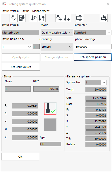

[Ed...] Posted October 7 Share Posted October 7 I just tested Passive Qualification, and the Reference Sphere's position does update when done manually and automatically. I tested this on a 543 with the 4mm pallet and removed and installed the reference sphere between runs. 1 Link to comment https://qualityforum.zeiss.com/topic/27583-masterprobe-and-probing-system-qualification-program/#findComment-156665 Share on other sites More sharing options...
[No...] Posted October 8 Share Posted October 8 I can't speak for XXT geometry requalification, but for passive, and also for tensor and 6 points on an VAST/XT. All of these run fine automatically and update the RS position. We use a setup like this for many years now. I guess any type of (re)calibrating the master probe is synonymous to updating the sphere location. Link to comment https://qualityforum.zeiss.com/topic/27583-masterprobe-and-probing-system-qualification-program/#findComment-156671 Share on other sites More sharing options...
[Da...] Posted October 8 Share Posted October 8 Yes it will do the master probe (Sphere Master Probe relationship) and update sphere position in the calibration program. I have setup 3 spheres in a calibration program works great. Link to comment https://qualityforum.zeiss.com/topic/27583-masterprobe-and-probing-system-qualification-program/#findComment-156687 Share on other sites More sharing options...
[Ja...] Posted October 9 Share Posted October 9 I'm wondering if we're talking about the same thing. I just tried using the Resources/Utilities/Probing System Qualification inside of a program to qualify the master probe/reference sphere and it definitely didn't update the reference sphere location. The probe went about 20" in -X immediately after running the qualification. I'm wondering if people are referring to using the caliper icon as being the "automatic" option. Or am I missing something? Link to comment https://qualityforum.zeiss.com/topic/27583-masterprobe-and-probing-system-qualification-program/#findComment-156758 Share on other sites More sharing options...
[No...] Posted October 12 Share Posted October 12 Please sign in to view this quote. All I can say is we are using exactly this to calibrate our probes since 2007 (when we migrated to Calypso) and it works reliably. We have to locate the sphere manually once (e.g. after maintenance) but after that all qualifications are done with probe calibration programs via Autorun. Each program starts with the master probe, followed by the probes to be calibrated. Link to comment https://qualityforum.zeiss.com/topic/27583-masterprobe-and-probing-system-qualification-program/#findComment-156782 Share on other sites More sharing options...
