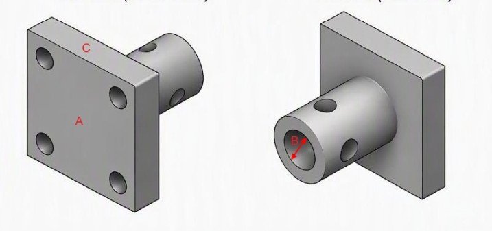

[Se...] Posted October 8 Share Posted October 8 (edited) Hallo zusammen, ich suche aktuell nach einer guten und eindeutigen Lösung, um die Querbohrungen verdrehgesichert zum stirnseitigen Bohrbild zu definieren bzw. zu bemaßen. Eine Skizze zur Verdeutlichung habe ich angehängt. Vielen Dank schon mal vorab für eure Hilfe 👍 Edited October 8 Link to comment https://qualityforum.zeiss.com/topic/27607-verdrehgesicherte-bema%C3%9Fung-der-querbohrungen/ Share on other sites More sharing options...
[Ma...] Posted October 8 Share Posted October 8 I see no problem. If it's for base alignment and you can always hit your datums while on fixture, then you don't need anything else. Other question is how much can real part differ against model in close places, like holes. 1 Link to comment https://qualityforum.zeiss.com/topic/27607-verdrehgesicherte-bema%C3%9Fung-der-querbohrungen/#findComment-156679 Share on other sites More sharing options...

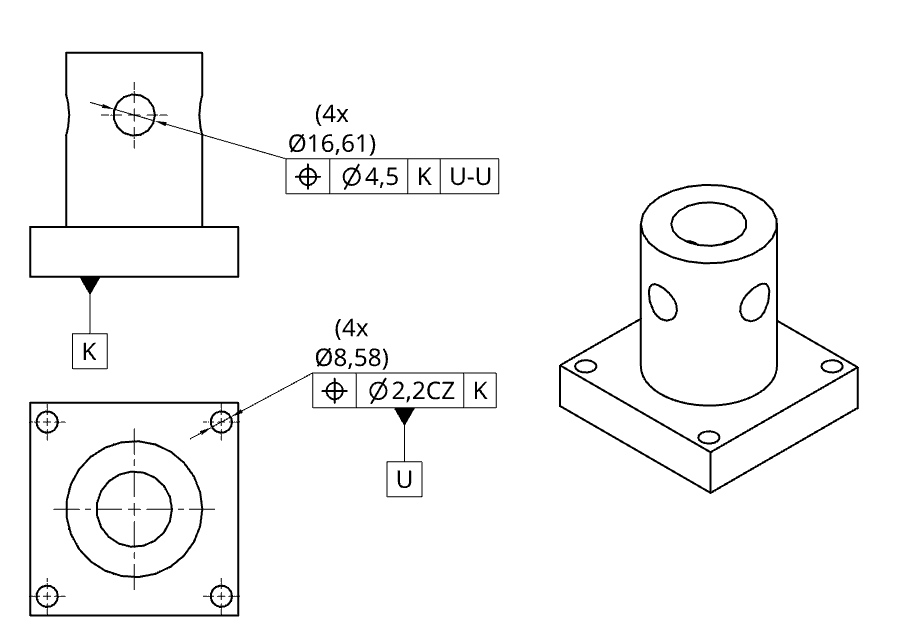

[na...] Posted October 8 Share Posted October 8 Please sign in to view this quote. This? -> 1 1 Link to comment https://qualityforum.zeiss.com/topic/27607-verdrehgesicherte-bema%C3%9Fung-der-querbohrungen/#findComment-156681 Share on other sites More sharing options...
