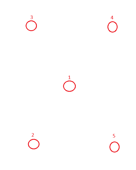

[Ri...] Posted October 8 Share Posted October 8 From my XXT probe checking program where I use the 5 standard articulations (1 thru 5). I use the Reference Sphere, XYZ zero is set by the MasterProbe. I then use each articulation and measure the sphere. I report the True Position (TP) for each articulation at .0003 Sphere (Shape of zone). If any are OOT I investigate the issue. Using a Contura 900x1200x600 I run this program once a month (I do a similar test with the VAST XTR Gold). Every month, the Reference Sphere is placed in a new location, I use 5 standard location and two levels of height in Z axis (My riser is 6 inches). This is how I detect nonconformities with a sensor; this method allows the sensor (either one) to move in a wide area around the Reference Sphere while taking measurements and uses a good portion of my volumetric area. Typically, I can detect if a stylus, a sensor or a quadrant has an issue that should be evaluated, after evaluation if found to be a non-fixable issue in house it is escalated to Zeiss. I have been using this method for almost 20 years, and it hasn't failed me yet. As an FYI, I also perform this test with no filters or outliers to detect sensor issues, but I use a wider tolerance. When I run without filters and outliers, it is considered a non-quality program and not for suitable part measurements. I plot data from both programs in excel which tells me if something is wrong. The second program is only run when I think there is an issue after the all testing of the first program is exahuasted. Over laying bell curves of the quality program and the non-quality program should reveal shifts that indicate an issue. 1 1 Link to comment https://qualityforum.zeiss.com/topic/27609-xxt-normal-verification-values/#findComment-156708 Share on other sites More sharing options...
[Mi...] Posted October 8 Author Share Posted October 8 OK so you're saying that you set your limit at .0005in true position. Which aligns with my understanding as well for an expectation, maybe a little tighter than I would've said but broadly the same. I like your strategy of moving the cal-sphere around the table for subsequent iterations. I think that's a good set-up in general. I've had some ideas as to how to codify the verification moving forward, I think I'll incorporate some of that. Anyway, thank you, I appreciate it. I was really just looking for someone who is very familiar hands on with an XXT to share what their standard is for location verification. Everyone I talked to was somewhat back and forth on what numbers I should be holding that to. Link to comment https://qualityforum.zeiss.com/topic/27609-xxt-normal-verification-values/#findComment-156710 Share on other sites More sharing options...
