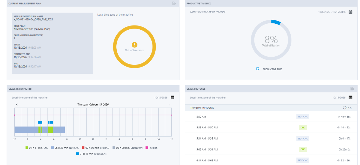

[M....] Posted October 15 Share Posted October 15 My Quality manager asked me if there was a way to see total runtime/uptime for the CMM? I know you can track via each program but I need total for all. Link to comment https://qualityforum.zeiss.com/topic/27670-total-runuptime-tracking/ Share on other sites More sharing options...

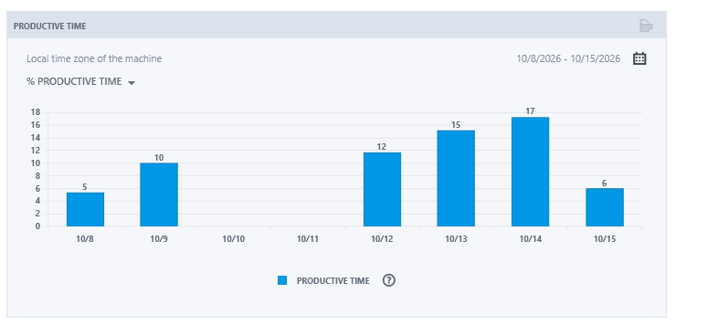

[Wo...] Posted October 15 Share Posted October 15 Not sure if SMA is needed for that, but if you set up smart services (even the free one), it will show you some stats. 1 Link to comment https://qualityforum.zeiss.com/topic/27670-total-runuptime-tracking/#findComment-157000 Share on other sites More sharing options...

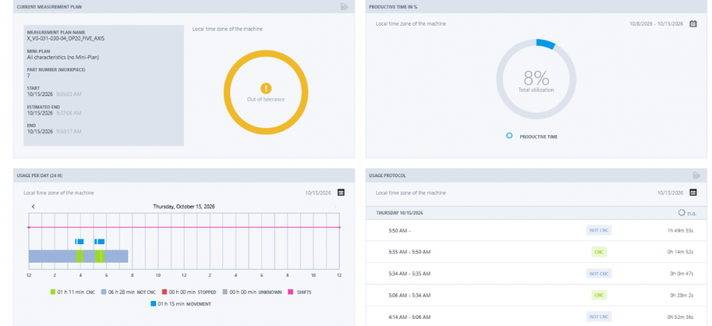

[Ka...] Posted October 16 Share Posted October 16 Looks like you runs smart services 🙂 Use the information button and you get this: 1 Link to comment https://qualityforum.zeiss.com/topic/27670-total-runuptime-tracking/#findComment-157016 Share on other sites More sharing options...

[Wo...] Posted October 16 Share Posted October 16 Please sign in to view this quote. Its called "General Data" in Smart Services Dashboard. Did you have it set up? You have to have Zeiss set it up for your machines. If not, you have to fill out the form on smart services website, Zeiss technicians will contact you, you'll have to install smart services service on each cmm pc, and then when you login with your zess account to smart services you'll see that dashboard for each of your machines. Link to comment https://qualityforum.zeiss.com/topic/27670-total-runuptime-tracking/#findComment-157064 Share on other sites More sharing options...
