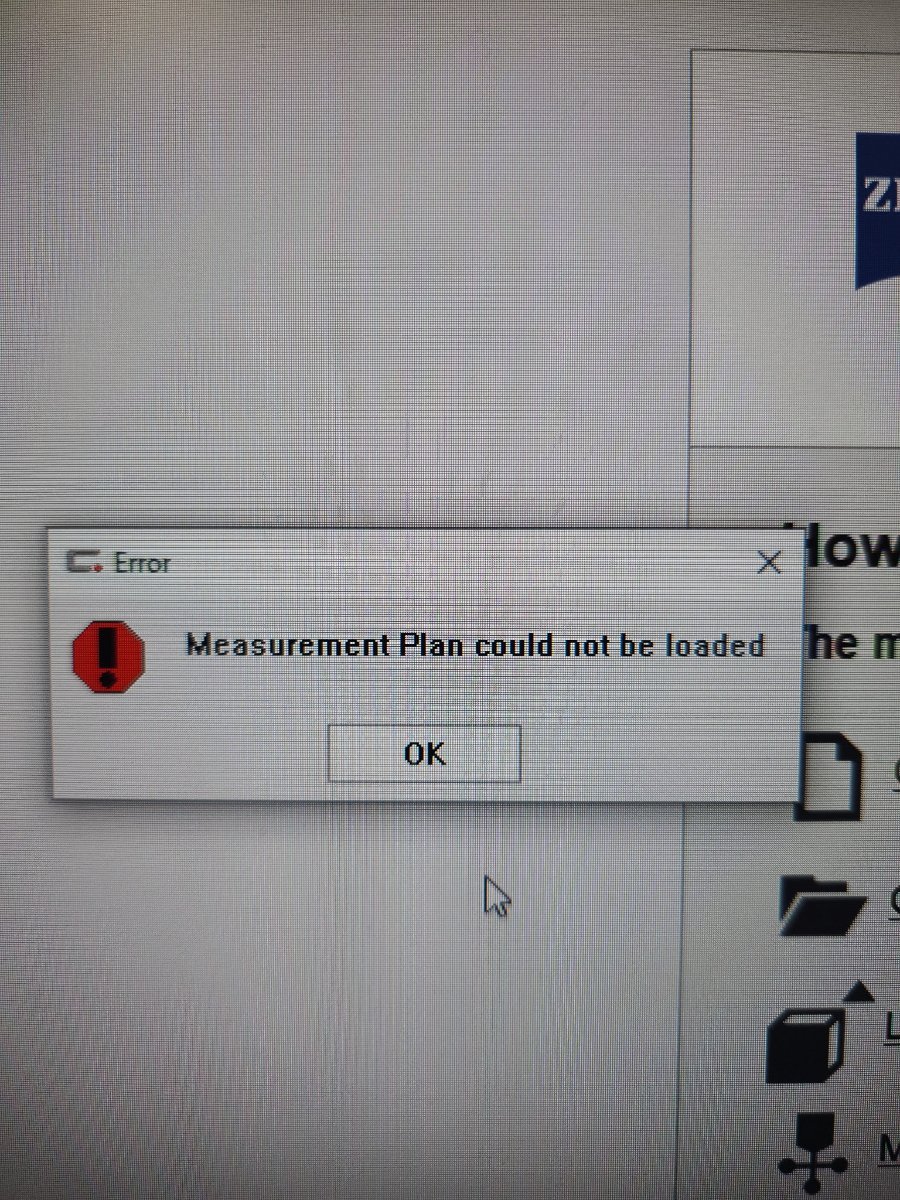

[Ra...] Posted October 15 Share Posted October 15 Had a customer send me a program I couldn't open. Their version is 7.8 and ours 7.6. In the past, I could just delete the version file from the folder or change version in notepad and save and no issues (usually) opening an new version in old. But not this time. Both are Win11 boxes. I looked through the program folder for default type files and nothing stood out. Is opening new in old not a thing anymore? Thanks! Link to comment https://qualityforum.zeiss.com/topic/27672-open-78v-in-76v/ Share on other sites More sharing options...
[Ma...] Posted October 15 Share Posted October 15 You can try out creating new blank program. Then copy into this new program files "inspection" and "inspset" and you should be able to open it. You can also copy model files. 1 Link to comment https://qualityforum.zeiss.com/topic/27672-open-78v-in-76v/#findComment-157010 Share on other sites More sharing options...
[Ra...] Posted October 16 Author Share Posted October 16 Please sign in to view this quote. Thanks Martin. I did try that but still same error. I actually then just tried the "inspection" only and it still errored same error. I'm thinking maybe there's some security stamp on the file from the customer as they're pretty locked down there with the IT department. Maybe I'll try copying and pasting the contents of those two files from notepad into my version and not the files themselves. Who knows! Link to comment https://qualityforum.zeiss.com/topic/27672-open-78v-in-76v/#findComment-157048 Share on other sites More sharing options...
[Ma...] Posted October 16 Share Posted October 16 If you can share those two files i can look into them. Changing versions can be tricky - i found two mentions about versions in both files ( inspection / inspset ) - "changeswi" and "creationswi" Also in "inspset" file there is dictionary of converted versions. Feel free to PM me 🙂 1 Link to comment https://qualityforum.zeiss.com/topic/27672-open-78v-in-76v/#findComment-157056 Share on other sites More sharing options...
