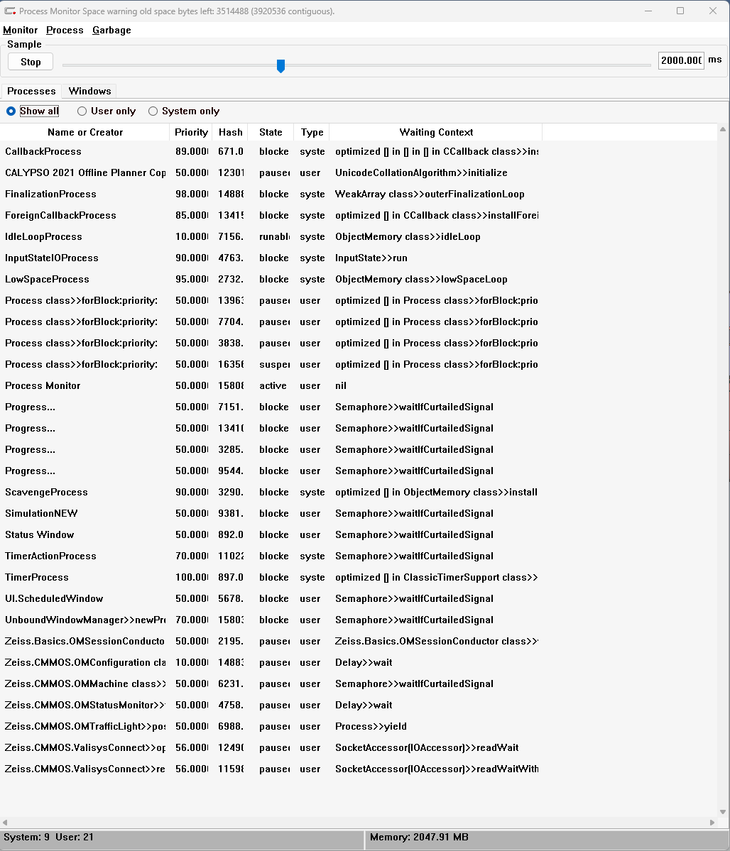

[Jo...] Posted October 21 Share Posted October 21 Hey all, I keep running into an issue with a specific program while saving. I receive the screen below. How do I proceed from this window? Or how do I prevent this from popping up? Appreciate the help! Link to comment https://qualityforum.zeiss.com/topic/27708-error-when-saving-process-monitor-space-warning/ Share on other sites More sharing options...
[Jo...] Posted October 21 Author Share Posted October 21 P.S... I have attempted to try different methods to proceed using the dropdown menus. This usually ends with the software freezing and the program not saving. Link to comment https://qualityforum.zeiss.com/topic/27708-error-when-saving-process-monitor-space-warning/#findComment-157234 Share on other sites More sharing options...
[Ri...] Posted October 23 Share Posted October 23 Drawing a straw. If its one program, create a new program and move everything over to the new program. 1 Link to comment https://qualityforum.zeiss.com/topic/27708-error-when-saving-process-monitor-space-warning/#findComment-157330 Share on other sites More sharing options...
[Jo...] Posted October 23 Author Share Posted October 23 Please sign in to view this quote. Appreciate the suggestion Please sign in to view this username. . My one issue would be that it is such a complex program; it would be a bear to transfer and could risk corruption. The way I got around this issue was by updating one feature at a time and saving each time. It was a pain, especially since it took about 2 minutes to save each time. 1 Link to comment https://qualityforum.zeiss.com/topic/27708-error-when-saving-process-monitor-space-warning/#findComment-157336 Share on other sites More sharing options...
