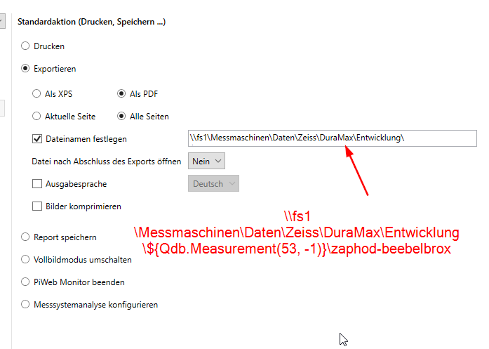

[Ka...] Posted October 22 Share Posted October 22 Hello, I need a dynamic path for printing PiWeb logs. For example, I want to use the order number as a path variable. That would be ${Qdb.Measurement(53, -1)}. With the standard “Print” action, you can define the file path/name. If I enter the variable in the file path, it isn’t expanded—instead, a file path with the variable name is created. What is the syntax for dynamic paths? Link to comment https://qualityforum.zeiss.com/topic/27710-print-a-dynamic-path-in-standard-action-print/ Share on other sites More sharing options...
[Ed...] Posted October 22 Share Posted October 22 I made a custom variable to make the path. 1 Link to comment https://qualityforum.zeiss.com/topic/27710-print-a-dynamic-path-in-standard-action-print/#findComment-157298 Share on other sites More sharing options...
[Ri...] Posted October 22 Share Posted October 22 Every "\" has to be typed as a double "\\" R:\\CustomerName\\Results\\SR#${Qdb.Measurement(1800, -1)}\\SR#${Qdb.Measurement(1800, -1)} - ${Qdb.Part(1901)} - Calibration Certificate - SN# ${Qdb.Measurement(2216, -1)}.pdf 1 Link to comment https://qualityforum.zeiss.com/topic/27710-print-a-dynamic-path-in-standard-action-print/#findComment-157300 Share on other sites More sharing options...
