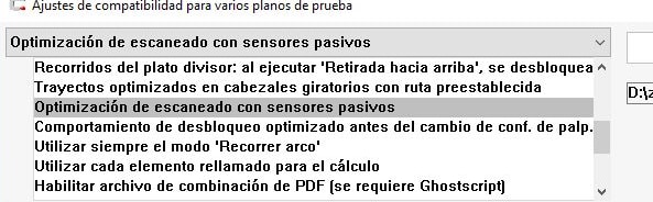

[Da...] Posted October 23 Share Posted October 23 (edited) Good morning, colleagues, Where can I enable or disable the option to repeat the measurement of an item—for instance, in cases where it was processed too quickly or without the necessary force? Edited October 23 Link to comment https://qualityforum.zeiss.com/topic/27722-avoid-repetition-of-an-element/ Share on other sites More sharing options...
[Ma...] Posted October 23 Share Posted October 23 I would guess in features editor, but i never saw that option. I was only using a loop to remeasure feature on condition. Link to comment https://qualityforum.zeiss.com/topic/27722-avoid-repetition-of-an-element/#findComment-157316 Share on other sites More sharing options...
[No...] Posted October 23 Share Posted October 23 (edited) Do you mean the rescan function of an XXT? It's in the compatibility options, but I don't remember what it's called. You'll know it when you see it. I think you can only enable or disable for the whole measurement plan. In older plans its off by default (backwards compatibility), in new ones it's on. Edited October 23 1 Link to comment https://qualityforum.zeiss.com/topic/27722-avoid-repetition-of-an-element/#findComment-157318 Share on other sites More sharing options...
[Sv...] Posted October 23 Share Posted October 23 If an XXT probe is being used, I sometimes adjust the speed. For instance, if I’m scanning a bore at 10 mm/s and the operation is repeated continuously, I’ll reduce the speed to 8 mm/s—that usually helps. I also once came across a solution on the forum where a circle is probed using four individual points; then, within the scanning measurement element, the actual X and Y positions are retrieved via a formula. 1 Link to comment https://qualityforum.zeiss.com/topic/27722-avoid-repetition-of-an-element/#findComment-157322 Share on other sites More sharing options...
[Da...] Posted October 23 Author Share Posted October 23 Please sign in to view this quote. Así es, muchas gracias! 1 Link to comment https://qualityforum.zeiss.com/topic/27722-avoid-repetition-of-an-element/#findComment-157324 Share on other sites More sharing options...
[Lu...] Posted October 23 Share Posted October 23 if you have too mutch air scanning warnings you should ajust the stylus on calibration and in program the force from standard to rubust Link to comment https://qualityforum.zeiss.com/topic/27722-avoid-repetition-of-an-element/#findComment-157326 Share on other sites More sharing options...
[Ri...] Posted October 23 Share Posted October 23 Please sign in to view this quote. Correct, I had asked a similar question in regard to Scanning Optimization with the XXT sensor. It can only be disabled program wide and is not recommended to disable. Link to comment https://qualityforum.zeiss.com/topic/27722-avoid-repetition-of-an-element/#findComment-157332 Share on other sites More sharing options...
[Ma...] Posted October 23 Share Posted October 23 certain features like circles allow you to put in a reference feature which will allow you to move faster without the air scanning. for those I do a 3 or four point circle as my reference then in a separate feature use the scanning option to go faster. this is helpful if you have a problem child, but doing it for every circle is not always faster. Link to comment https://qualityforum.zeiss.com/topic/27722-avoid-repetition-of-an-element/#findComment-157338 Share on other sites More sharing options...
