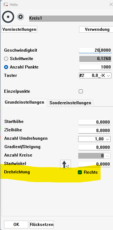

[Se...] Posted October 26 Share Posted October 26 Hallo, kennt jemand einen PCM Befehl um die Drehrichtung umzuschalten? Grüße Sebastian Link to comment https://qualityforum.zeiss.com/topic/27742-drehrichtung-umschalten/ Share on other sites More sharing options...
Popular Post [Ma...] Posted November 3 Popular Post Share Posted November 3 (edited) Please sign in to view this username. What about this approach: Create both strategies in one element (like in pictures below) Next step is to programmatically set the strategy using "setElementStrategy" directionOfHelix = inquireList("Select direction of a helix:", "right", "left") setElementStrategy("Circle1",directionOfHelix) Edited November 3 6 Link to comment https://qualityforum.zeiss.com/topic/27742-drehrichtung-umschalten/#findComment-157752 Share on other sites More sharing options...
