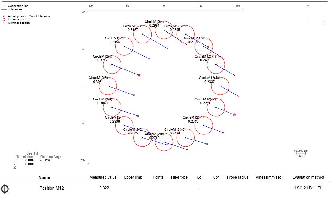

[Ed...] Posted October 30 Share Posted October 30 Hi, I have question regarding true position plots, I saw the same question in previous posts, bet there wasn`t clear answer. I have bore pattern of 16 M12 holes. My question is why I have the result of hole bore pattern, but I don`t get result for every individual hole, I mean illustration? Is there possibility to leave illustration of hole bore pattern, but turn of this individual bores? Thanks in advice 🙂 Link to comment https://qualityforum.zeiss.com/topic/27784-piweb-true-position/ Share on other sites More sharing options...

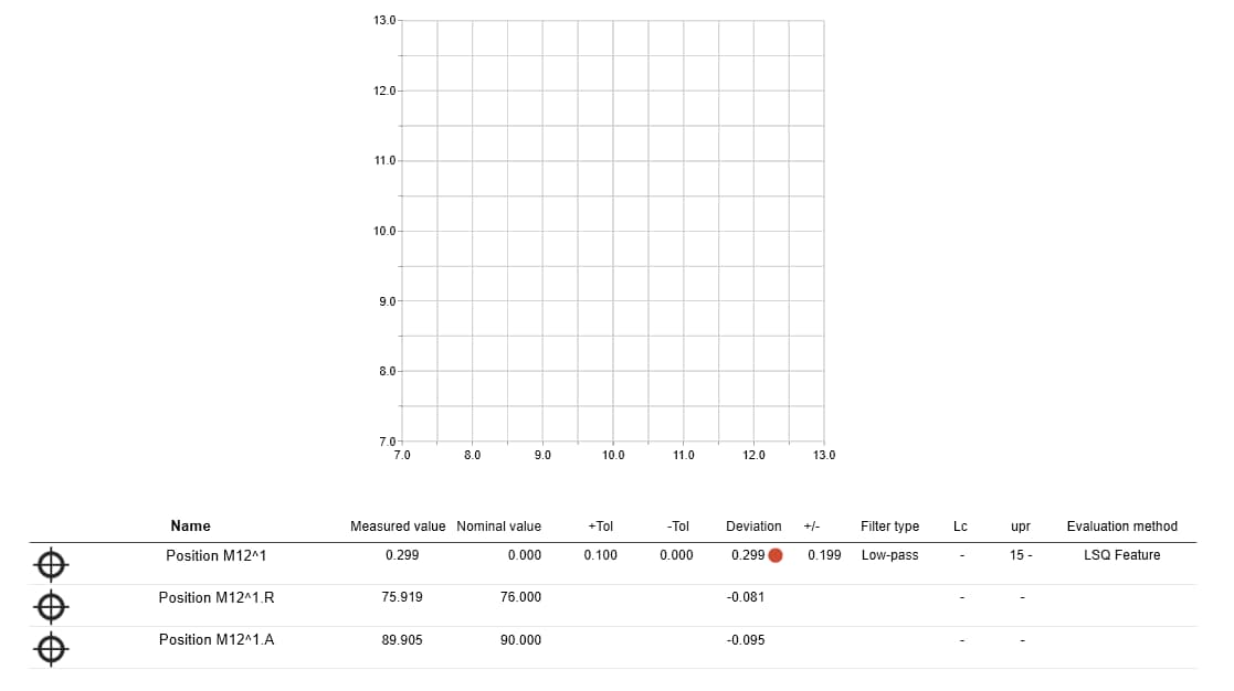

[Ma...] Posted November 13 Share Posted November 13 Hello Edgars, sorry for the late reply. If you turn on the "additional report" you should also get every individual bore shown on the protocol: If you dont want to have the combined bore pattern plot on the protocol, i think you will have to create a generic PiWeb Template where you delete the marked rows in the "BorePattern.Bor (Detailed)" and adjust the size of the plot view itself: Which would be look like this: I hope this helps! Have a nice weekend! Best Regards Marcel 1 Link to comment https://qualityforum.zeiss.com/topic/27784-piweb-true-position/#findComment-158274 Share on other sites More sharing options...
[Ri...] Posted Monday at 04:43 PM Share Posted Monday at 04:43 PM I didn't think this worked if you had Polar Coordinates turned on though. 1 Link to comment https://qualityforum.zeiss.com/topic/27784-piweb-true-position/#findComment-158350 Share on other sites More sharing options...
[Ed...] Posted Tuesday at 06:46 AM Author Share Posted Tuesday at 06:46 AM Please sign in to view this quote. Yes, you are right. It doesn`t work with Polar Coordinates. Somebody knows why? And if I turn off additional report, turn on display plots in report, I will have plot of bore pattern and no individual features like I wanted, but then it doesn`t show XY deviations, only total. 😞 Link to comment https://qualityforum.zeiss.com/topic/27784-piweb-true-position/#findComment-158366 Share on other sites More sharing options...
[Ri...] Posted Tuesday at 01:08 PM Share Posted Tuesday at 01:08 PM Yeah - I'm not certain why it doesn't work. In the past, when you exported in Polar Coordinates it would also export in Cartesian, so that you could perform the "bullseye" analysis. Link to comment https://qualityforum.zeiss.com/topic/27784-piweb-true-position/#findComment-158400 Share on other sites More sharing options...
