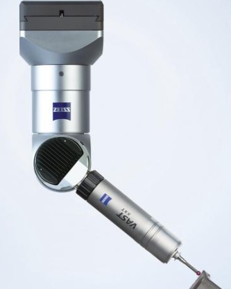

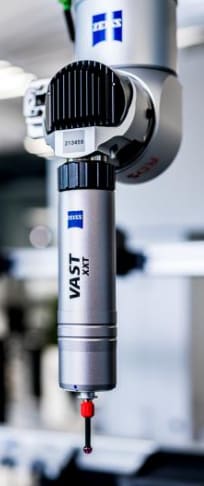

[Ma...] Posted October 30 Share Posted October 30 Fixed i meant VAST XT and others where you have fixed probe rotation. With RDS you can rotate probes around head axis ( Z ) and also another angle. RDS 1 Link to comment https://qualityforum.zeiss.com/topic/27790-probe-orientation-numbers/#findComment-157670 Share on other sites More sharing options...
[Ri...] Posted November 2 Share Posted November 2 I use a similar naming convention on RDS and XT, XTR sensors. Only one caveat, the number one stylus would be 1 A0B0 (Using your examples), number 2 "2 A90B-65". Or your naming: 1 0_0 2 90_-65 Basically, just adding the stylus number indicating the stylus used within Calypso (Calypso doesn't care about the name, it's all about the index number). I have not had any issues with measuring results or qualification. 1 Link to comment https://qualityforum.zeiss.com/topic/27790-probe-orientation-numbers/#findComment-157700 Share on other sites More sharing options...
