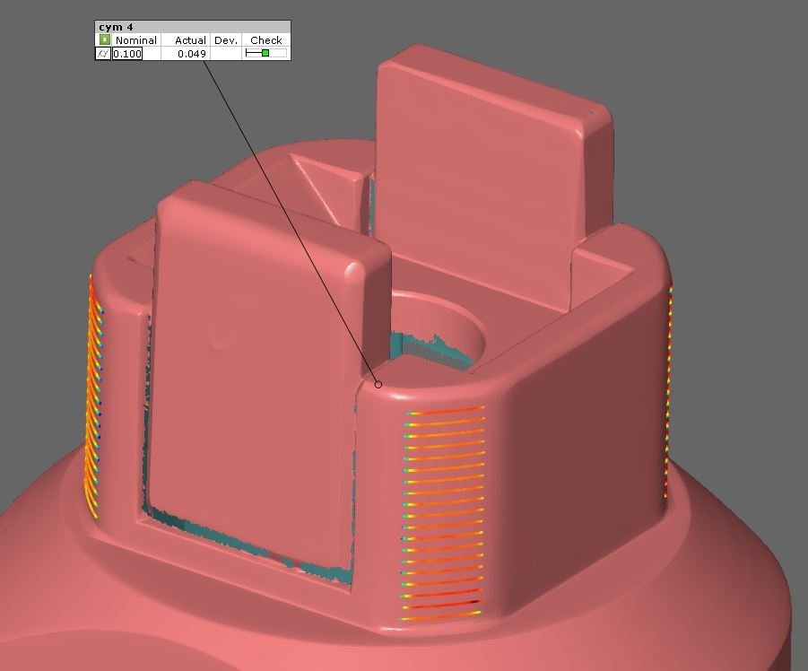

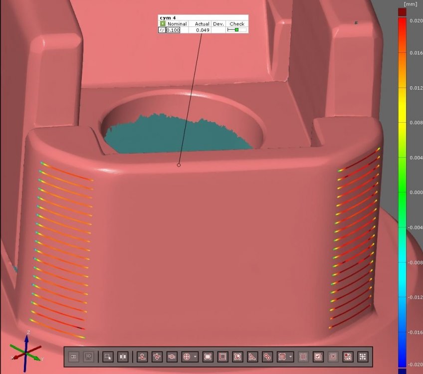

[Da...] Posted April 6, 2023 Share Posted April 6, 2023 (edited) HI all, i wish i may write it in easy way because its quite complicated thing - like for me. I have this part and my client wants to see the deviation on cylinder Because do not have model i have tried to make cylinder by manual selecting and show him graphics of cylindricity but its hard to select only outside diameter without radii around it. And my cylindricity was about 0.25~0.3 So color deviation representation was not much usefull. Here with sections i have 0,05 and with color deviation representation i can this can show me how much wear is on diameter - i can see what there is less use on lower part, this was not visible with cylindricity ~0.3 But my selection is making errors in my report because now color deviation representation shows what some radius around my diameter are larger than other but i cannot be sure of it Because of selecting manualy, too much it causes my cylidricity to grow - and this causes my color deviation representation to loose exact informations - lilke it was when i make first cylinders with cylindricity around 0.3 So i need to perfectly same selection shape for each part of my cylinder, and need them to be perfectly oriented around my datum system. How to do it ? or is any easier method ? Edited April 6, 2023 Link to comment https://qualityforum.zeiss.com/topic/2831-advanced-selection-how-to-do-it/ Share on other sites More sharing options...

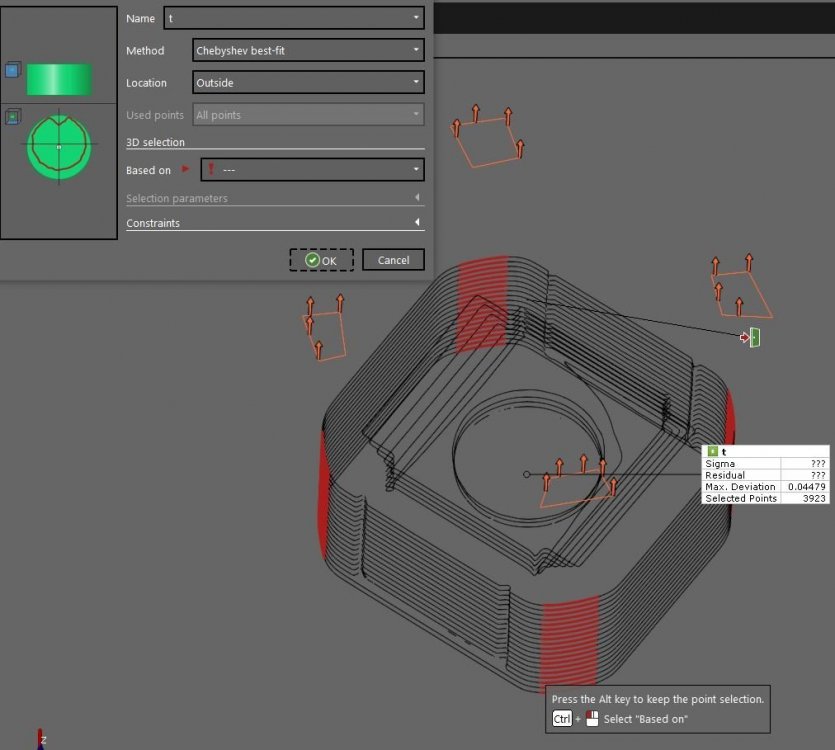

[Na...] Posted April 11, 2023 Share Posted April 11, 2023 Hello Damian, there are many selection tools in the menu under Edit -> selection in 3D. Maybe selection inside geometry contour will help in this case? https://techguide.gom.com/en/gom-software-2022/article/cmd_selection3d_select_by_geometry_contour.html You could create four point-direction Cylinders for example, which are then used for the selection. Regards, Nanno Link to comment https://qualityforum.zeiss.com/topic/2831-advanced-selection-how-to-do-it/#findComment-7501 Share on other sites More sharing options...
