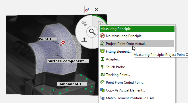

[Ma...] Posted April 11, 2023 Share Posted April 11, 2023 I'm trying for days to find a way to fix two points to a surface component in GOM corrolate, but when the deformation starts the points are fixed to the x y z-coordinates. The goal is to input two points in predetairmende coordinates and see the deformation just like point inspection. Does anyone know how to do this? Link to comment https://qualityforum.zeiss.com/topic/2837-is-there-a-way-to-fix-a-point-to-a-surface-and-fix-the-point-with-the-devormation/ Share on other sites More sharing options...

[Th...] Posted December 14, 2023 Share Posted December 14, 2023 Hello Maarten, as you describe it the feature you are searching for is new in ZEISS INSPECT Correlate 2023: Construct a nominal point at given Coordinates Give it the measuring principle "project onto actual" (Open I-Inspect to do this), choose your surface component to and use homologuos progression (default for surface components). Take take of alignments and the stage you are projecting in. 😉 Best regards, Thorsten Link to comment https://qualityforum.zeiss.com/topic/2837-is-there-a-way-to-fix-a-point-to-a-surface-and-fix-the-point-with-the-devormation/#findComment-9796 Share on other sites More sharing options...
