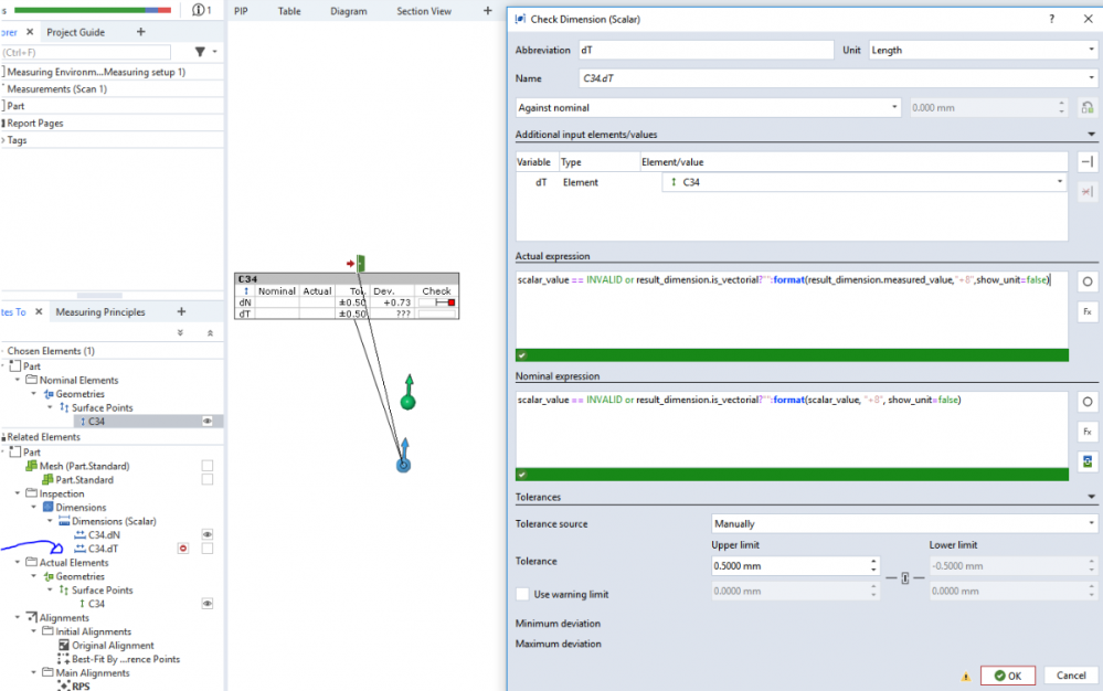

[Je...] Posted April 23, 2023 Share Posted April 23, 2023 I have been trying to change the "dN" deviation to "dT" in my output as I show below. Somebody know how to do it ? Link to comment https://qualityforum.zeiss.com/topic/2877-rename-a-check-eg-%E2%80%9Ct%E2%80%9D-instead-of-%E2%80%9Cdn%E2%80%9D/ Share on other sites More sharing options...
[Je...] Posted April 25, 2023 Author Share Posted April 25, 2023 Hello every one, I found the expression to do that. It was " dT.Actual_element " or depende of your personalized name. Link to comment https://qualityforum.zeiss.com/topic/2877-rename-a-check-eg-%E2%80%9Ct%E2%80%9D-instead-of-%E2%80%9Cdn%E2%80%9D/#findComment-7631 Share on other sites More sharing options...
