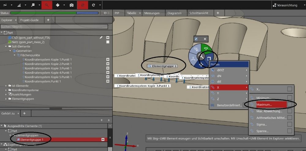

[Jo...] Posted June 28, 2021 Share Posted June 28, 2021 Hello, I'm trying to get the min and max deviation of an element group. This element group only contains X position values of surface points. Can anyone point me to the instructions how to get the min and max value of the deviations from this element group? Thanks in advance. Johnny Link to comment https://qualityforum.zeiss.com/topic/291-minmax-from-element-group/ Share on other sites More sharing options...
[Je...] Posted June 28, 2021 Share Posted June 28, 2021 Hello Johnny, to get max/min X-values you can check the element group, see the attached screen. GD&T is not supported yet (I will check that). Best regards, Jens Heidler Link to comment https://qualityforum.zeiss.com/topic/291-minmax-from-element-group/#findComment-823 Share on other sites More sharing options...
[Jo...] Posted July 4, 2021 Author Share Posted July 4, 2021 Thanks Jens, Actually the range is the value I was looking for. I thought I had to calculate it from the max and min value of the element group. But it is already available. ? Johnny Link to comment https://qualityforum.zeiss.com/topic/291-minmax-from-element-group/#findComment-845 Share on other sites More sharing options...
