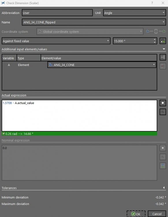

[Ti...] Posted May 28, 2023 Share Posted May 28, 2023 I'm having to go into the User defined area to get the opposing angle of a cone. Is there an easier way? Also, why in the am I trapped having to enter in radians instead of 90 - A.actual_value? Thanks Link to comment https://qualityforum.zeiss.com/topic/2979-is-there-a-way-to-flip-the-angle-of-a-cone/ Share on other sites More sharing options...
[Be...] Posted May 30, 2023 Share Posted May 30, 2023 Hi Tim, sorry, as far as I know there is no other way in the moment. But usually you can use predefined expressions for tasks like this via the Add-On-Manager (of course, you can specify the expression also manually like you did). Regarding radiants: Because we are using the token values of our elements in the user defined expression evaluation (for flexibility) you have to specify the formula in the units which we use for the tokens. Radiants are the usual way in scientific programs to represent angles or rotations. Regards, Bernd Link to comment https://qualityforum.zeiss.com/topic/2979-is-there-a-way-to-flip-the-angle-of-a-cone/#findComment-7879 Share on other sites More sharing options...
[Ti...] Posted May 30, 2023 Author Share Posted May 30, 2023 Please sign in to view this username. Thanks for the reply. I've never heard of the Add-On-Manager before. Where is that in the GOM workspace? I cannot find it. Thanks. Link to comment https://qualityforum.zeiss.com/topic/2979-is-there-a-way-to-flip-the-angle-of-a-cone/#findComment-7883 Share on other sites More sharing options...
[Be...] Posted May 30, 2023 Share Posted May 30, 2023 Sorry, I meant the package management (under Edit). Link to comment https://qualityforum.zeiss.com/topic/2979-is-there-a-way-to-flip-the-angle-of-a-cone/#findComment-7887 Share on other sites More sharing options...
