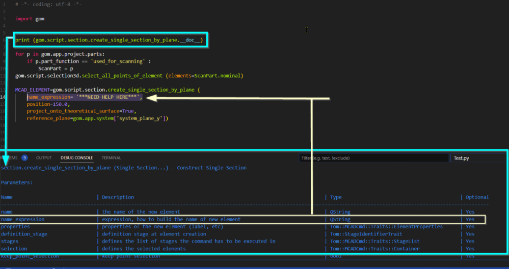

[De...] Posted May 29, 2023 Share Posted May 29, 2023 Hi, While scripting the creation of elements, I noticed you can pass an argument 'name_expression'. Does anyone have any additional information on this argument and how it can be used? what can I put after name_expression = , to have it create the element with an 'Automatically generated' name? Thanks! Link to comment https://qualityforum.zeiss.com/topic/2983-name_expression/ Share on other sites More sharing options...
[03...] Posted May 30, 2023 Share Posted May 30, 2023 Yes afaik "name_expression" will add a number to the name of whatever element you create so if you set "name_expression=Plane", it will create "Plane 1", "Plane 2" useful for when you are creating a bunch of new elements via script Link to comment https://qualityforum.zeiss.com/topic/2983-name_expression/#findComment-7893 Share on other sites More sharing options...
